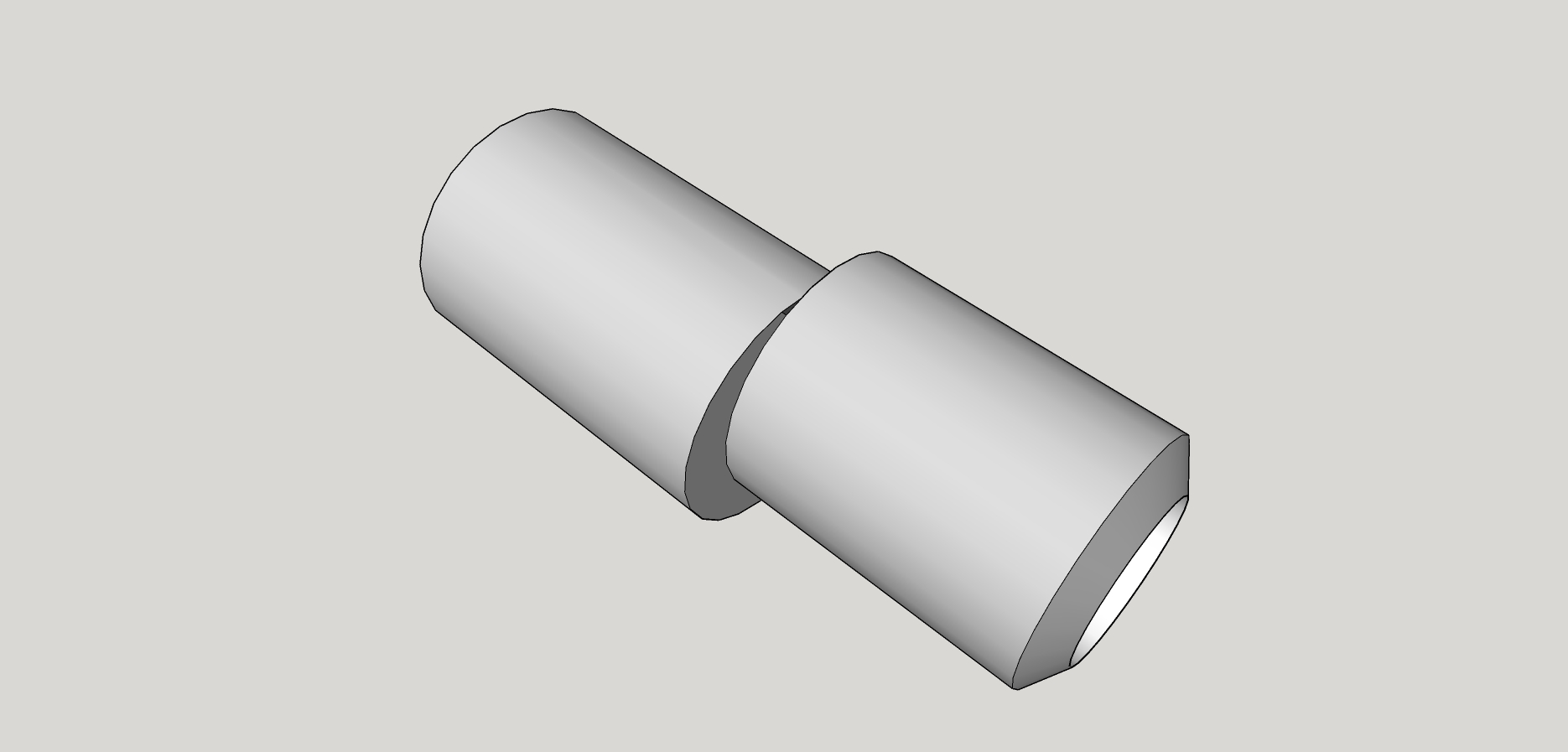

Those are not the tubes that I have. I linked to a Sketchup of what I have. I should have included dimensions but I did not. The tubes I have are one piece (nothing to flex) and are made from the same dimension tubing as are my main table legs.algale wrote:Dusty I am surprised and skeptical to hear that you can get the Shopsmith vertical with the aluminum table bandsaw mounted on normal eccentric tubes without having to at least tilt the bandsaw table. I know I can't.
If you truly can, it raises the question of why is Shopsmith selling these special "bandsaw" eccentric tubes, https://www.shopsmith.com/ownersite/cat ... gtubes.htm, which they advertise as the solution to getting the Shopsmith vertical "without having to remove the bandsaw from its mount."??
It is likely the offset (see my sketch) that makes the bandsaw table clear the tie bar when going vertical.

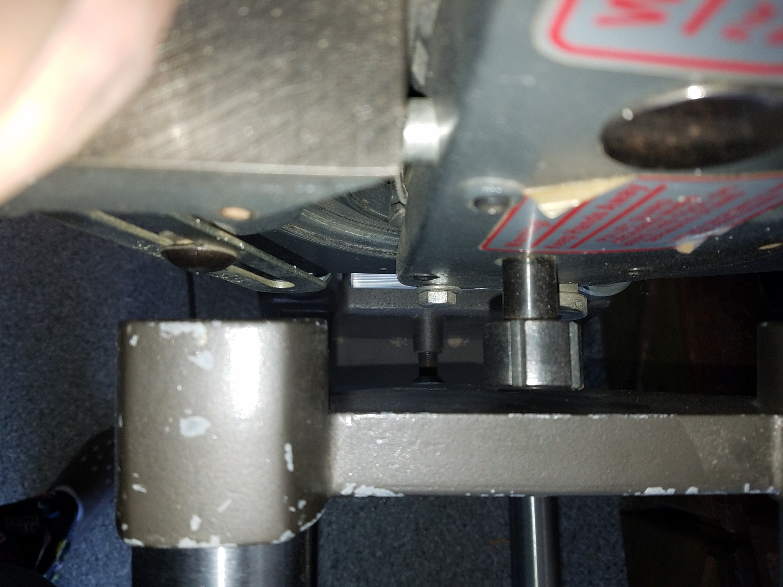

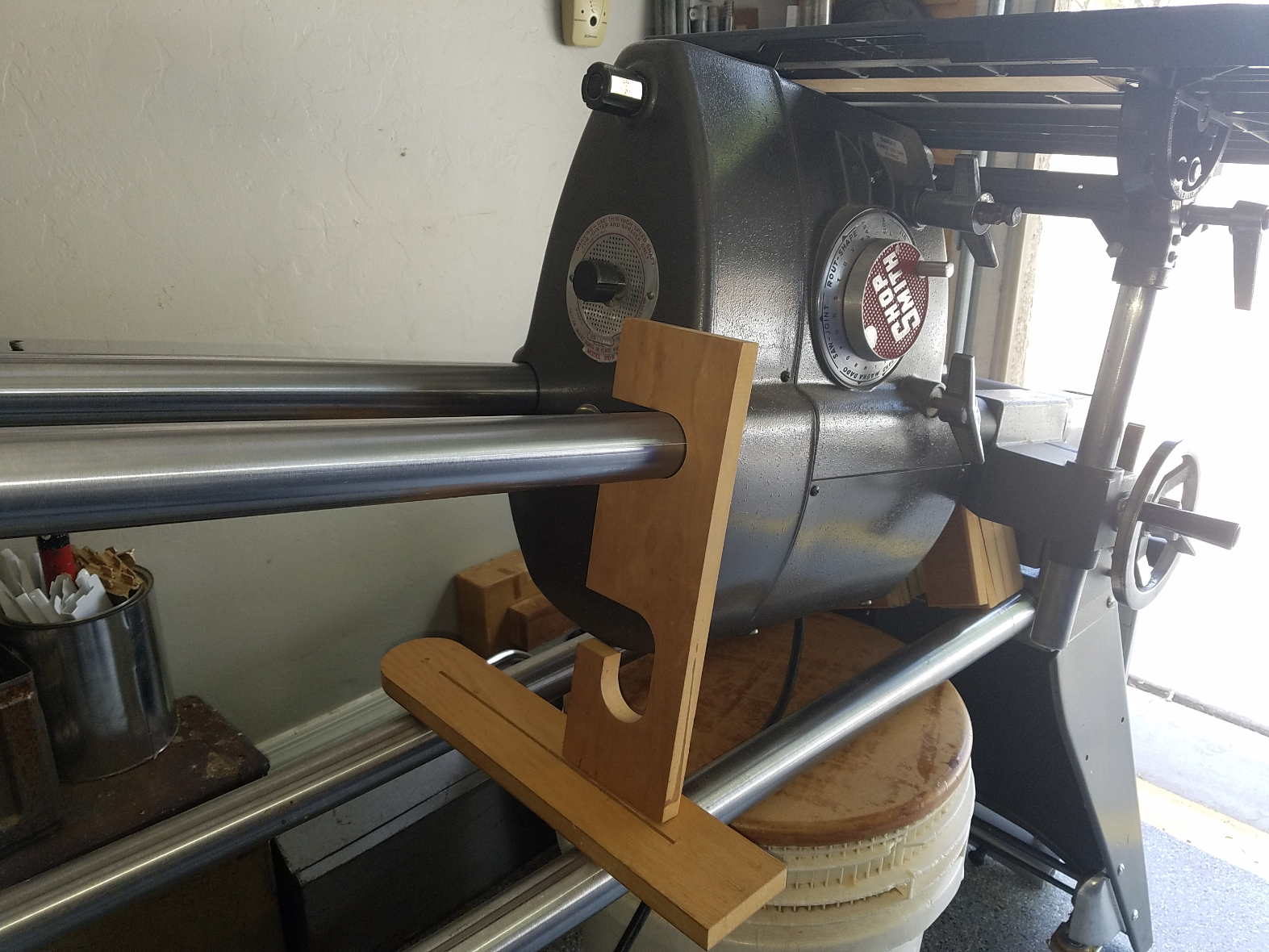

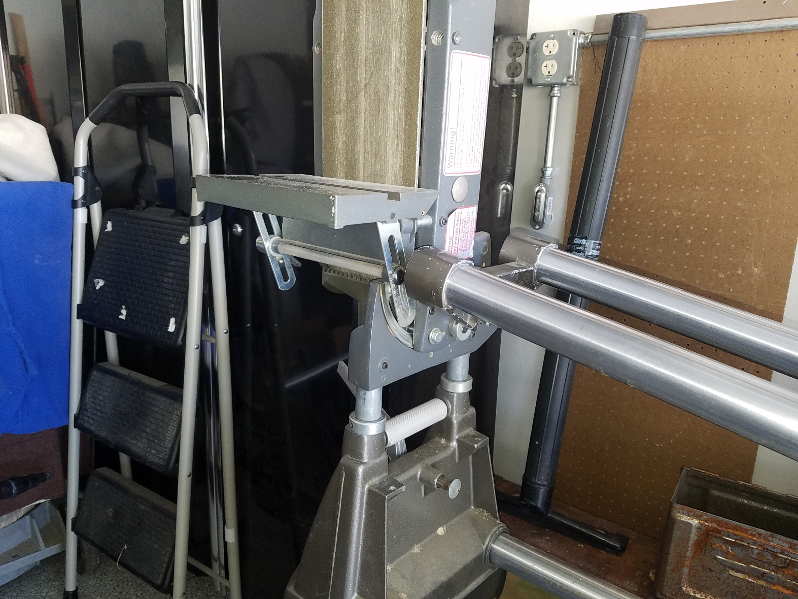

Readjust the eccentrics so as to move the bandsaw (to the left) away from the headstock end. If a remember correctly thiswill be 180 degree rotation of the eccentrics. Before you call that done, make sure that the hub still lines up laterally.
Just to help you become a believer I attached a couple very fresh photos even though it is 110 degrees in the shop. Have faith man. I try not to mislead anyone.
