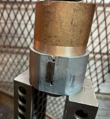

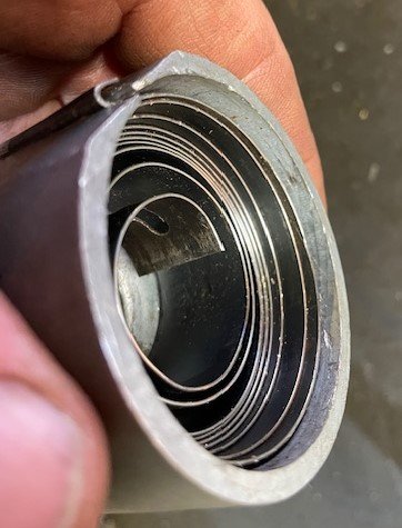

The First Quill spring was easy.
This one (Someone has been messing with. :eek:
It is tightly coiled on the outer Diameter.
So I knew better that to try to extract it from its Home. ;)
These are going in a Evapo-rust bath.

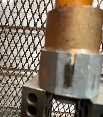

I turned down a piece of Bronze to press the spring back in the housing.
Before press Picture.
After press picture

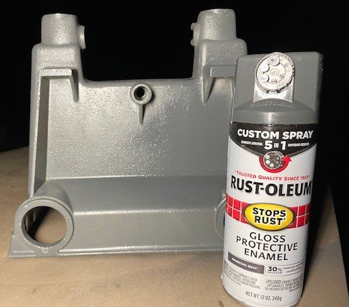

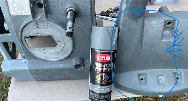

I had some Matte Deep Gray and its a No go.
This is another gray I had for my Milling machine.
This is what the color I am going to paint it.

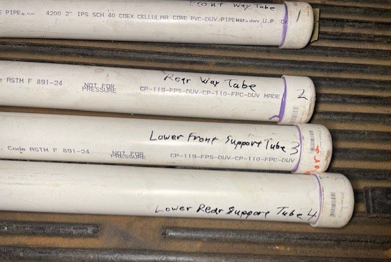

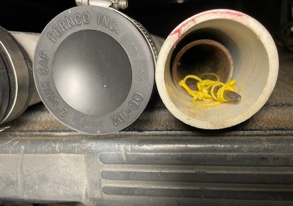

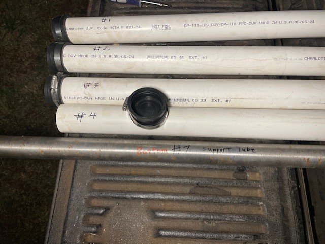

I bought 2 Sticks of PVC .
I got this idea from 2 members of this group. :D

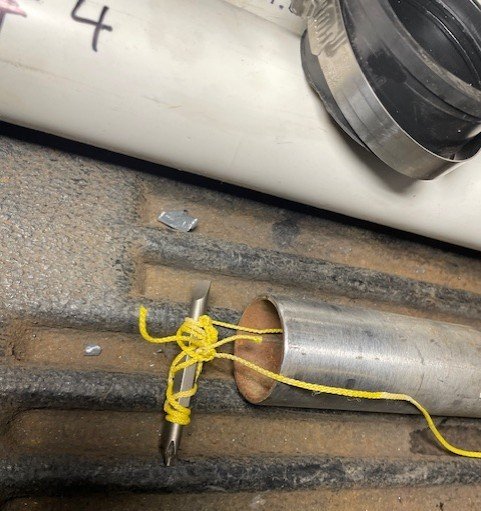

I cut them to leave a few inches for liquid for Evapo Rust.
I run with the ball with this idea.
I made 4 Tubes for keeping up with the Order of Stuff. :rolleyes:
I used another members idea about pulling this out of the tube. :cool:
Thanks /You know who this idea came from. :)

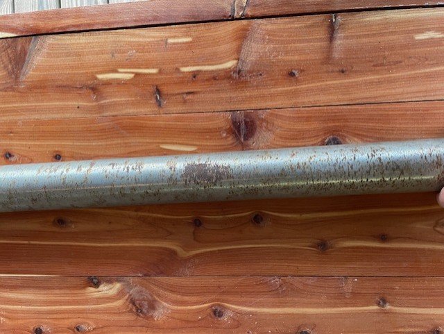

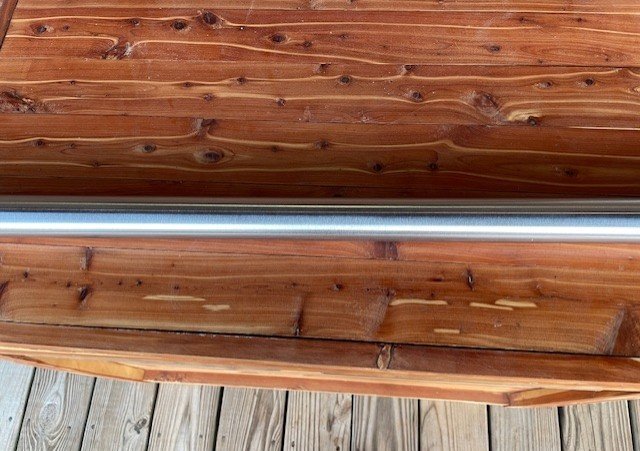

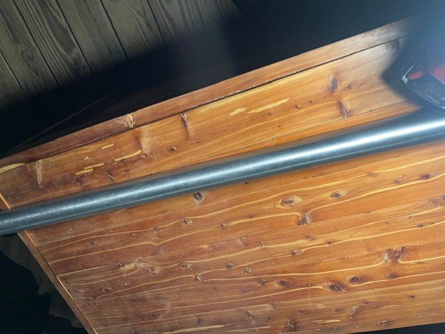

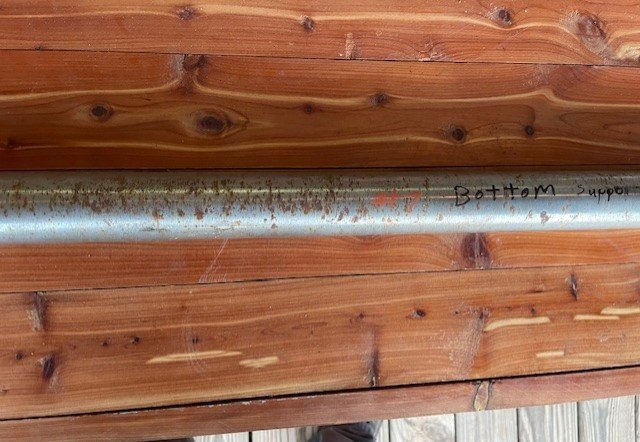

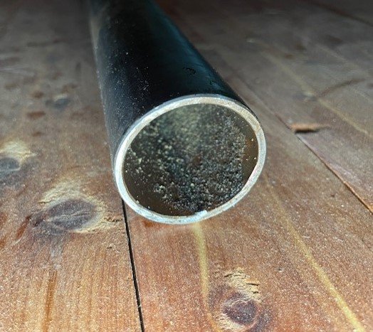

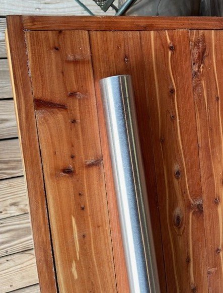

First tube reveal after Evapo-Rust since yesterday . :D
This is lower Support (back) tube.
Almost looks like New. :)
End of tube picture.
Okay now I will start the Next lower tube.

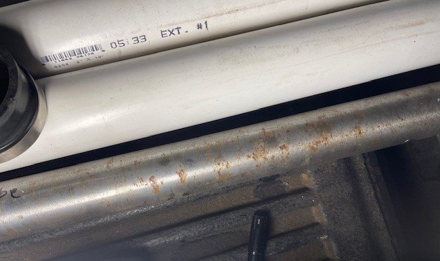

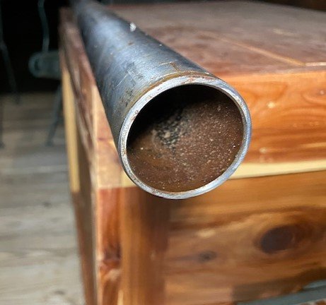

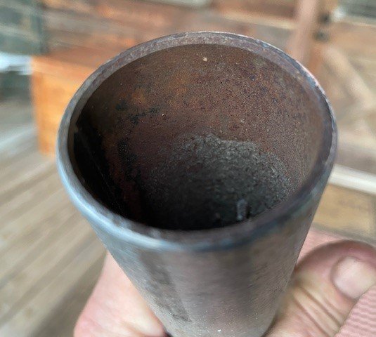

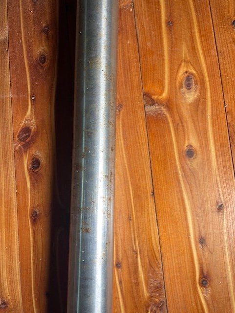

Front support tube ( before ) pictures.
It just got drop in the juice tonight. :cool:
Bottom side of tube. (Before)
Inside of worst end of this tube (Before) Picture.
I think I will let this one soak for 2 Days. :)

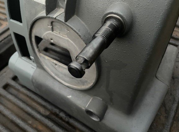

A little more Progress.

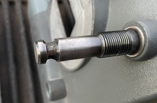

Cleaned this shaft and prepped for Blacken-ing

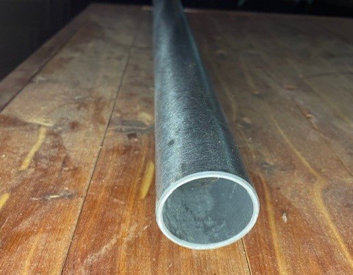

And some late night shots of the 2nd Clean tube. :)
This is the End that was (So) real Rusty. :eek: and now :)

I use Rust-oleum Charcoal Gray paint for my Model 10E and 10ER restorations. I find it close to the original paint color used on them. For me it is a little too glossy for the Model 10's, so I use a Rust-oleum Matte Clear Coat. I haven't used the Rust-oleum Charcoal Gray on a Mark V or any STP so far. For the one Gray Mark V (1982) I restored I used the Shopsmith Gray and have also used it for touch-ups. Painting an entire gray Mark V, it should look close to original for the color.
It looks like you are coming along very well in your restoration. I will enjoy seeing it when finished.
Thanks for the encouragement.
I had this paint on hand to paint a Bridgeport machine I am retrofitting.
I may use your idea about the matte clear coat.
It does have a shine.

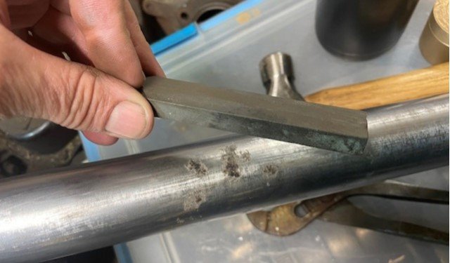

I Re-Blackened this side of the shaft.
I am using a paint filter to filter the Evapo-Rust before being poured into the next tube.
This is the only spots that didn't clean up with Tube Bath. :(
I worked them with a fine Stone and got it smooth and it's in for another Bath. :)

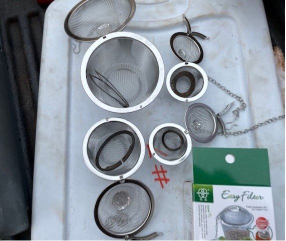

I got these little baskets off Amo zon to use for small parts.

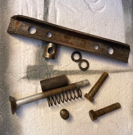

These are the Quill related washers.
Which I will ask questions about later. :D

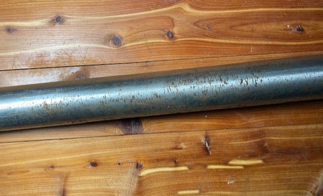

This is the front way tube (before) picture .
The evapo-rust is doing a Great job at cleaning the inside up as well.
This is a Before picture of the worst of the rust on this Front way tube

For small parts, I just used zip ties reversed so I could easily remove them and put them in the rust remover. Then I just grabbed the end of the zip tie to pull them out.

AllenH wrote: Mon Oct 28, 2024 5:07 pm For small parts, I just used zip ties reversed so I could easily remove them and put them in the rust remover. Then I just grabbed the end of the zip tie to pull them out.
Great Idea. :cool:
I will use that. :D
