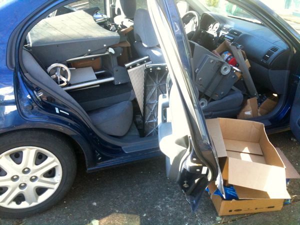

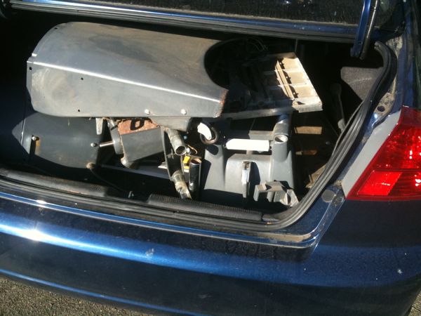

Reading this thread made me wonder if I kept these attached photos. This is a Honda Civic crammed with a full 510, floating tables, bandsaw, belt sander, full set of older 500 stuff, and stand-alone Planer. Took some time (more than 60 seconds, for sure) and thankfully the seller was both patient and very helpful.
I only used one third-party soft-handled allan wrench and an adjustable crescent wrench. Big steps were to remove the legs, and take the headstock off the rails, and after that is was just a strange game of Tetris to get everything loaded.
If you plan to do it yourself, I'd only recommend that you vacuum the passenger seat before driving your wife around later! :eek:

You coulda got a lot more in that Honda if you had packed more carefully.;) There are far too many UNoccupied spaces.:rolleyes:
