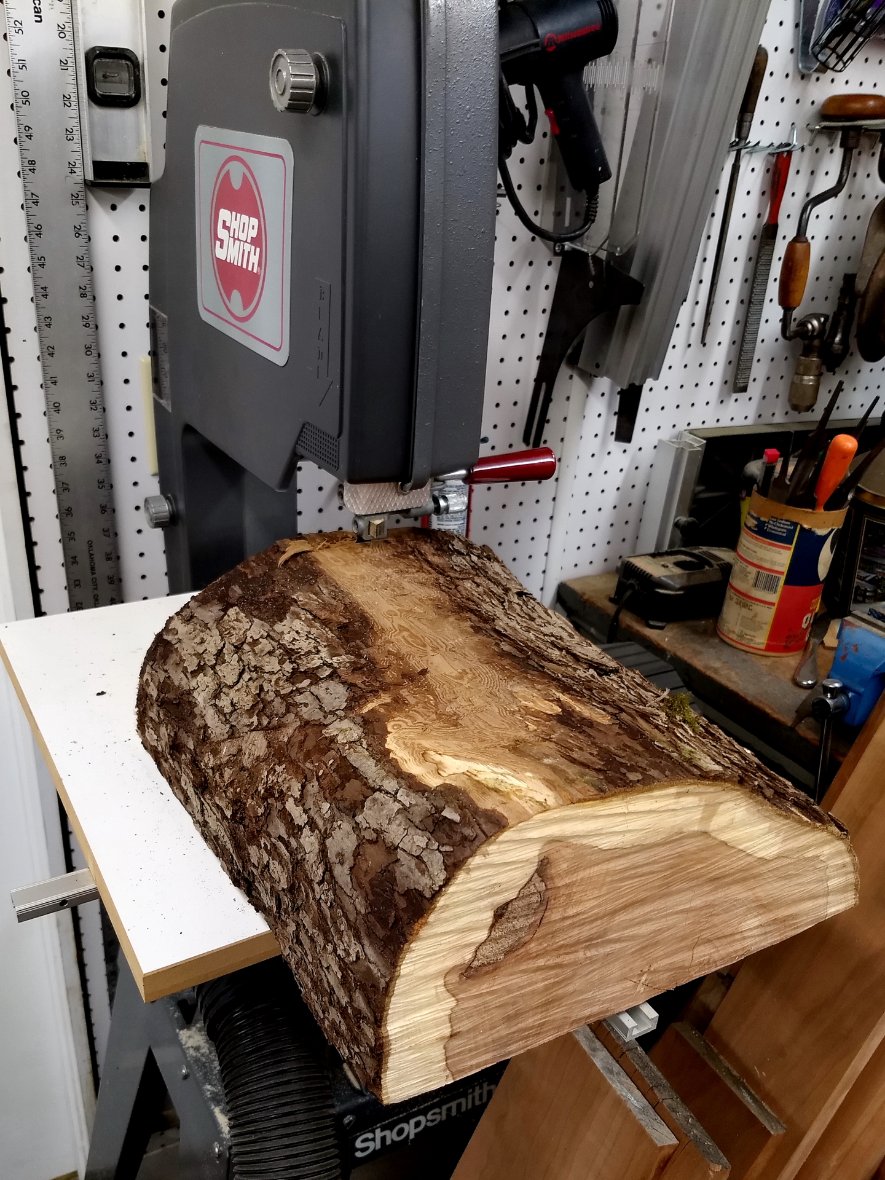

Back to the beginning. Here's a pic of the rough log half on my Shopsmith bandsaw. The white thing underneath it is a circle-cutting jig.
I used a 6" faceplate to mount the blank for rough-turning the bowl bottom. The "flat" side of the blank wasn't very flat, as it was just rough-cut with a chainsaw. So to make sure that the faceplate mated up nicely with the blank, I covered it with blue painters tape, applied blobs of hot glue to it, and then stuck it all to the bowl blank. Once cooled, the hot glue formed shims to fill the gaps. Then I screwed the faceplate to the blank as per normal. I intentionally mounted it a bit off-center, to try and equalize the amount of sapwood on each side of the bowl.

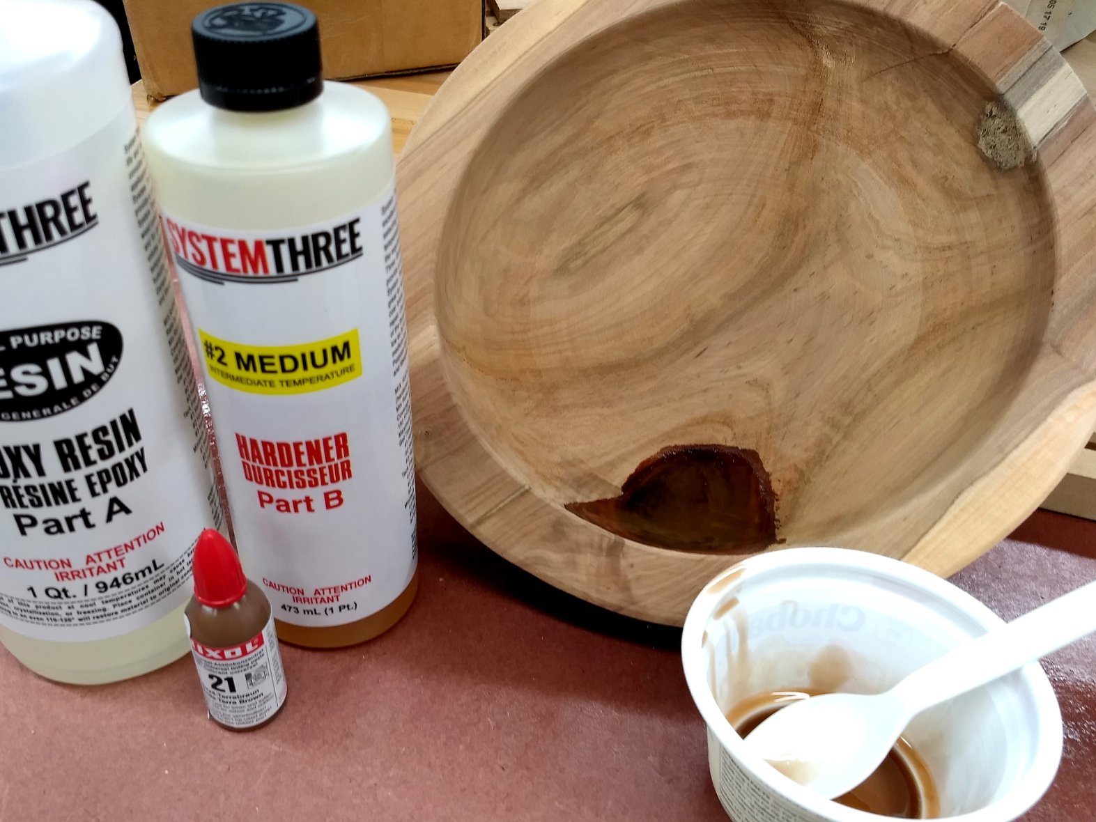

After rough-turning the interior of the bowl, all the wood defects were exposed. The knot holes were pretty punky, and needed to be filled. Also, I used an accelerated dessicant-drying technique on the rough-turned bowl, and this opened up a few cracks. To fill all these, I used thin slow-curing epoxy, with a few drops of colorant added. I just eyeballed the color, adding drops until it was about the same color as the darker streaks in the apple heartwood. The thin epoxy quickly wicks down into the defects, and I kept adding it until the the wicking stopped.
The epoxy looks ugly at this stage, but that's gonna change!
