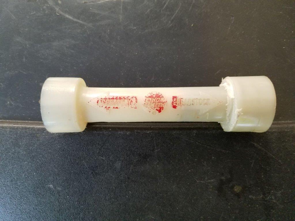

Just talked with cust service. At first she wanted to "set an appointment" to talk with someone. That was going to cost me $19.99 for 15 minutes. She said the power couplers had been the same for 35 years. I explained the original I had was translucent and these new ones were hard white plastic material. Obviously not the same as my original. I don't know when they actually changed.
From my order history she saw that these were under warranty, so is having someone call me back today at 12:30. I emailed pictures which she is forwarding to the person who will call me back.
for reference, here's pix of the original coupler used throughout the years for jointer and bandsaw. We think I got my Shopsmith Mark V in 1985 and have upgraded it (table, powerhead, lift assist, etc.) many times since.
Stay tuned,
hal

Re: melted/broken power coupler
The couplers (old and new) are identical fit and form...but...they are not identical otherwise. I don't know what it is that causes this but they are not the same color. My guess would be the formula for the plastic. Are these from a mold or are they extrusions?
