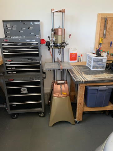

With a 9 1/4" bench tube the foot print of dedicated shorty drill press is 29"x20".
I have not noticed any stability issues when using the drill press. With the support posts the table is rock solid / no flex at all.
I ended up going to a 9 1/4 inch bench tube because it set the edge of the 500 table just over the support posts. If I were doing this with a 510/520 table I would follow jsburger's recommendation of an 18" bench tube.

Re: Dedicated Drill Press
In between tearing my hair out over the Power Pro upgrade (just kidding, I don't have that much hair left
), I cut a couple of pieces of bench tube using the junkiest makeshift metal cutting bandsaw there ever was, but it worked. I de-rusted those and the clamps and put them into the base ends, without the legs though. It looks good for now, I'll put in on the legs as soon as I find some screws, and if I can get the Power Pro all set up then I can mount the old 510 headstock on this and I'll be all set. Well, except for having to take the base and legs all apart and do a lot of cleaning and painting, but first I want it up and working.
Ed from Rhode Island

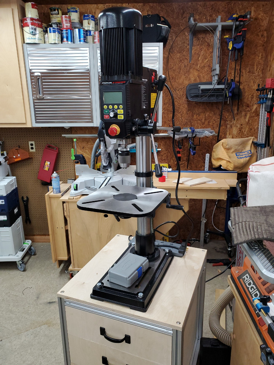

In keeping with the tech o my PowerPro here is my dedicated drill press.
Jack
Jack
I've seen that DP. It's pretty amazing. You set a depth stop and it automatically stops and reverses. The one I saw can start slow and then up the speed, for drilling things like glass. It had a bunch of other tricks, too.
