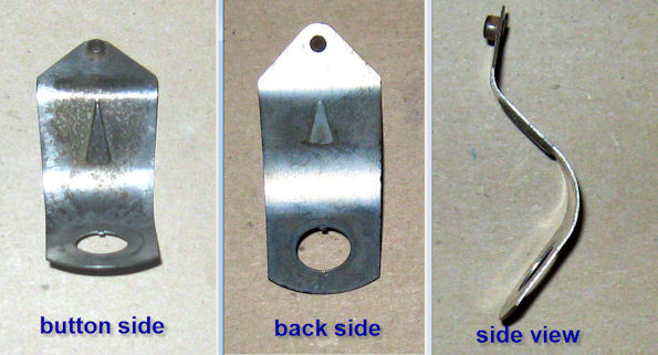

Jeff (restonut), I think this is the piece you described:
[ATTACH]14260[/ATTACH]
If so, I do not need it since I converted my greenie to a dedicated drill press and powered it with a tread mill motor, ( in a post here http://www.shopsmith.net/forums/showthr ... rill+press) so if you PM me your mailing address, I would be pleased to send it to you.(free)

Peter - That is exactly what I need. Mine is gone from the curve that goes down to the button though. PM sent!
