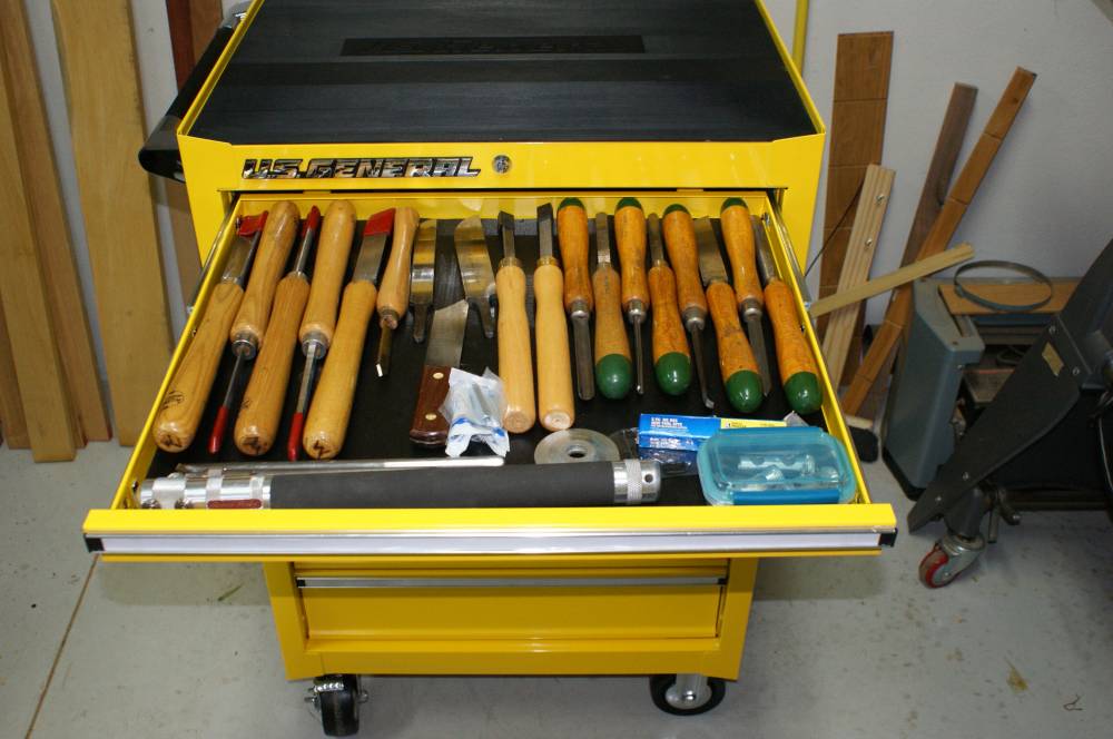

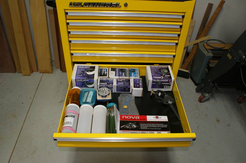

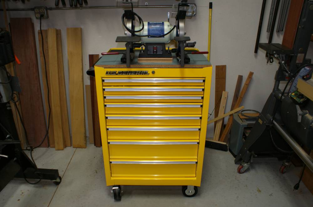

I have the Rikon low speed 1/2 HP grinderand the Oneway Wolverine grinding station in my shop. I spent a fair amount of coin experimenting with grinding systems over the years and the one I have now is working out as the best. I wish I had some more guidance earlier.
Here is my sharpening station.
Bill V
Bill V

Thank You all for your imput. Bill V your grinder set up is WICKED nice. I like thing kept clean and tight as well so I appreciate your design and efforts. Well Done & Thankyou.
