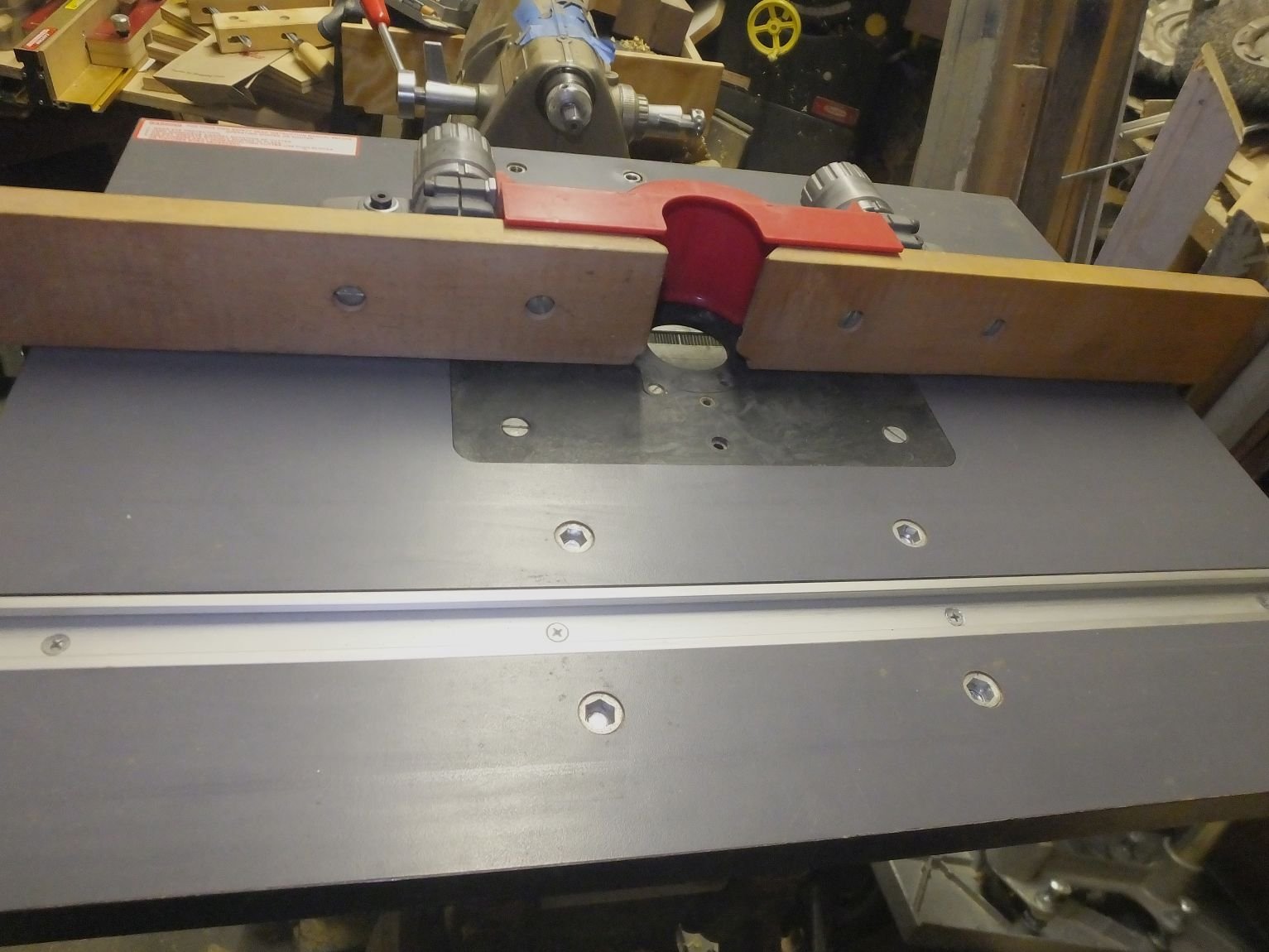

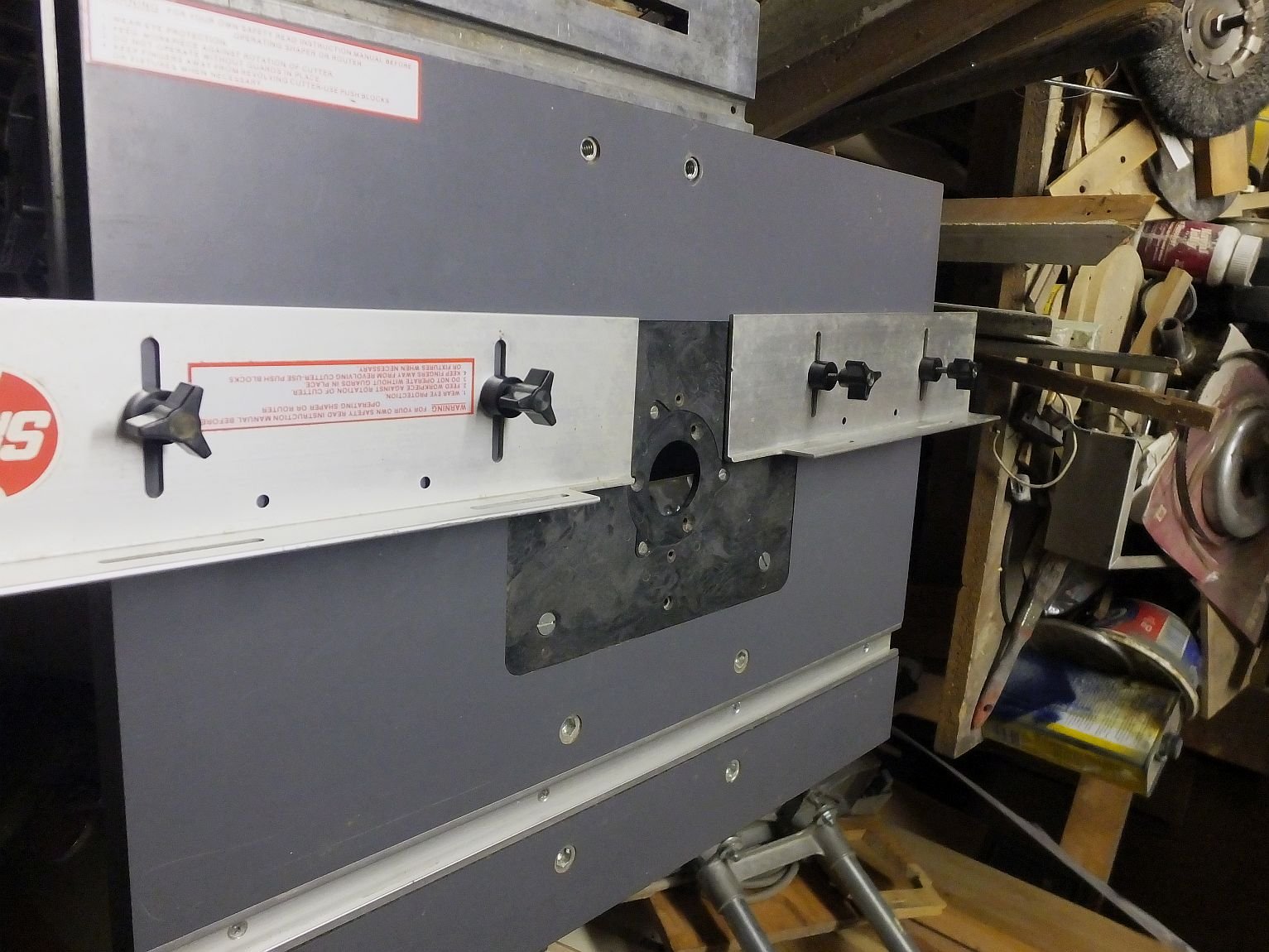

Although typical these days, I am not impressed with the extruded aluminum "angle iron" with long slots. Neither do I like the positioning clamps that require several turns of the three fluted knobs. Pix is rotated from horizontal.
I decided to make an alteration.
2hole(s) location.jpg (315.01 KiB) Viewed 1657 times

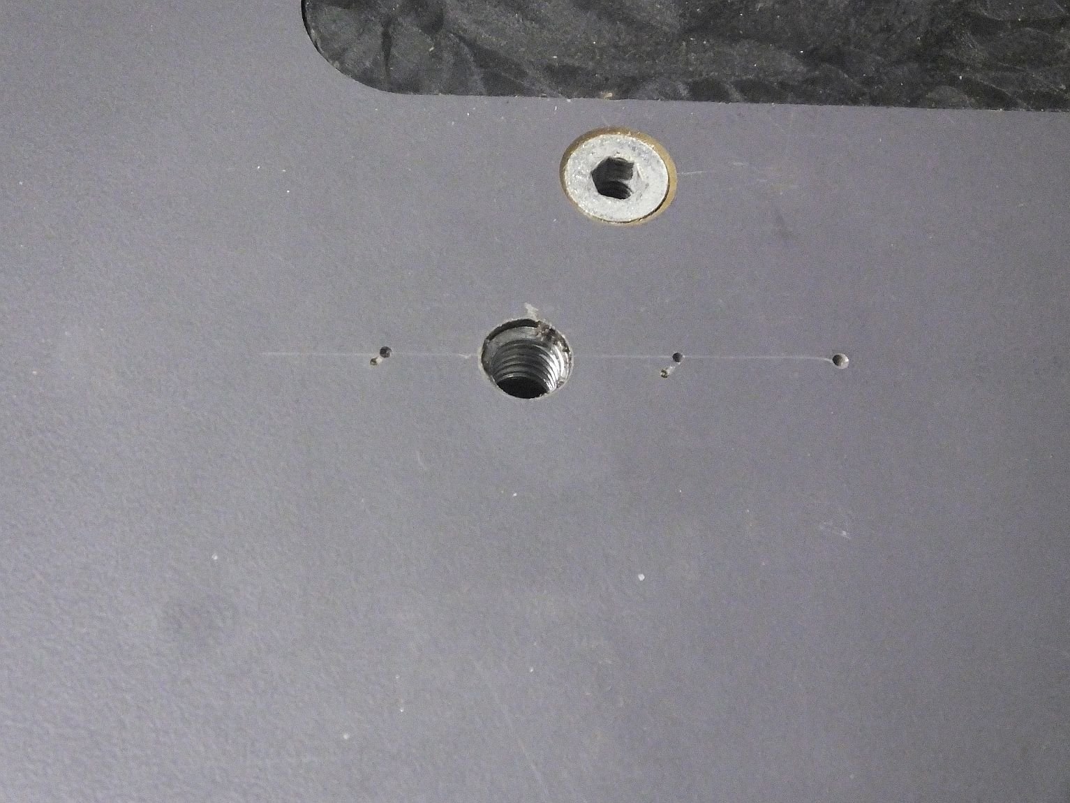

Without any thought I marked 4 locations each for 2 sets of clamping t-nut holes. Upon some thought occurring I decided on one of those 4 locations. That location is very close to 510/520 table holes for a "real" shape/rout/sand fence.

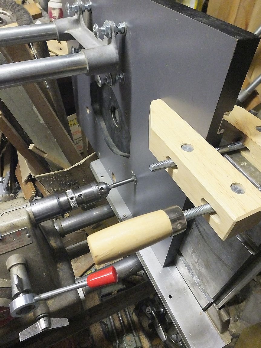

So counter bored two holes with 7/8" bottom and 3/8" top diameter. 3/8 for a t-nut sleeve and 7/8 for the t-nut flange od. Used a "horizontal drill press".
3horizontal boring.jpg (218.97 KiB) Viewed 1657 times
Awkward fer sure but I had already aligned the 'legs'. Not impressed with table raw material - resembled impregnated paste board(think cereal boxes).

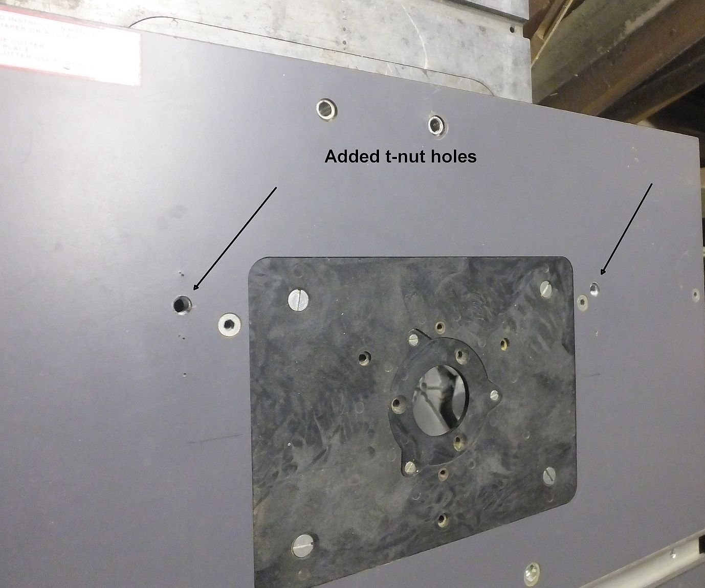

Holes done.
4tnut holes.jpg (187.49 KiB) Viewed 1657 times

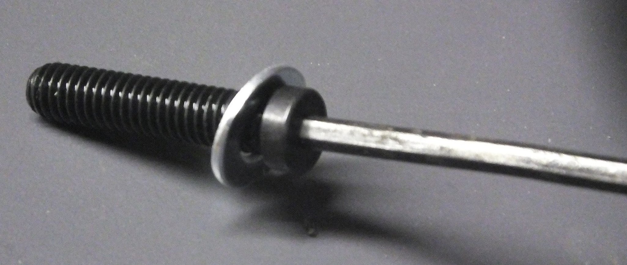

Now What to use in those t-nuts.
5.16-18 LOW 5.32.jpg (489.24 KiB) Viewed 1657 times
5/16-18 low profile cap screw that has a 5/32 hex socket.
The deed is done!
Screw length results in about 2 turns needed to tighten once threads are engaged. I intend to make washers with a tighter fit to the screws. The fence is the current version.
