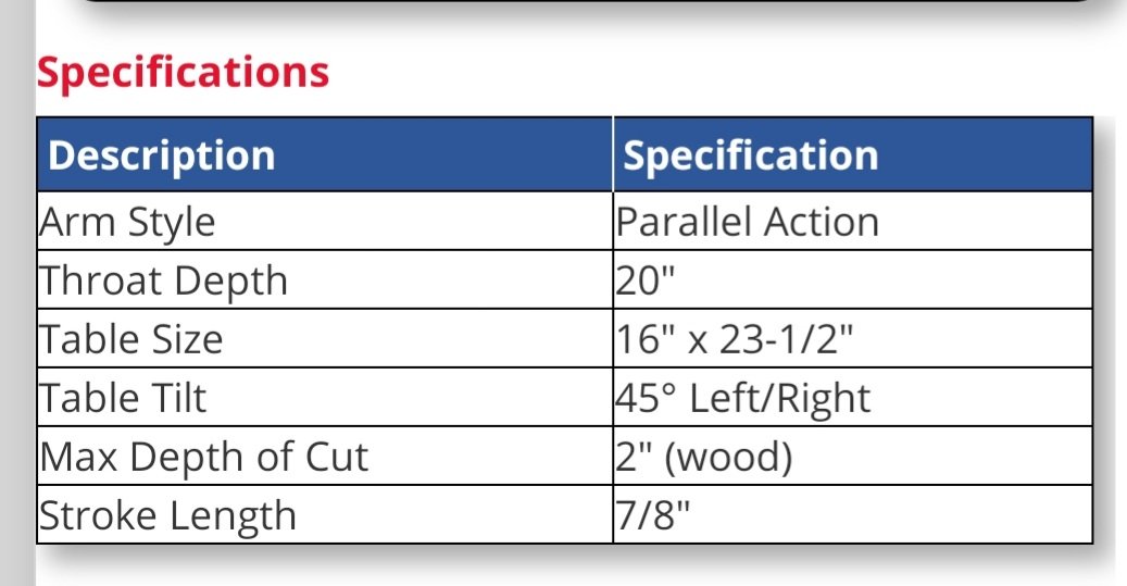

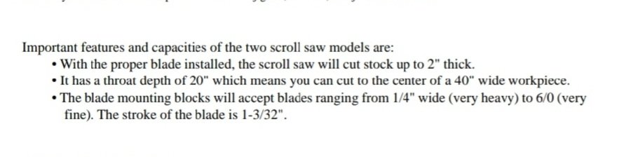

Then I saw conflicting information regarding stroke length in Shopsmith documentation. The Teal scroll saw is specified as having a 7/8" stroke, while the Shopsmith Academy page (with pictures of the grey scroll saw) lists a stroke of 1 3/32".

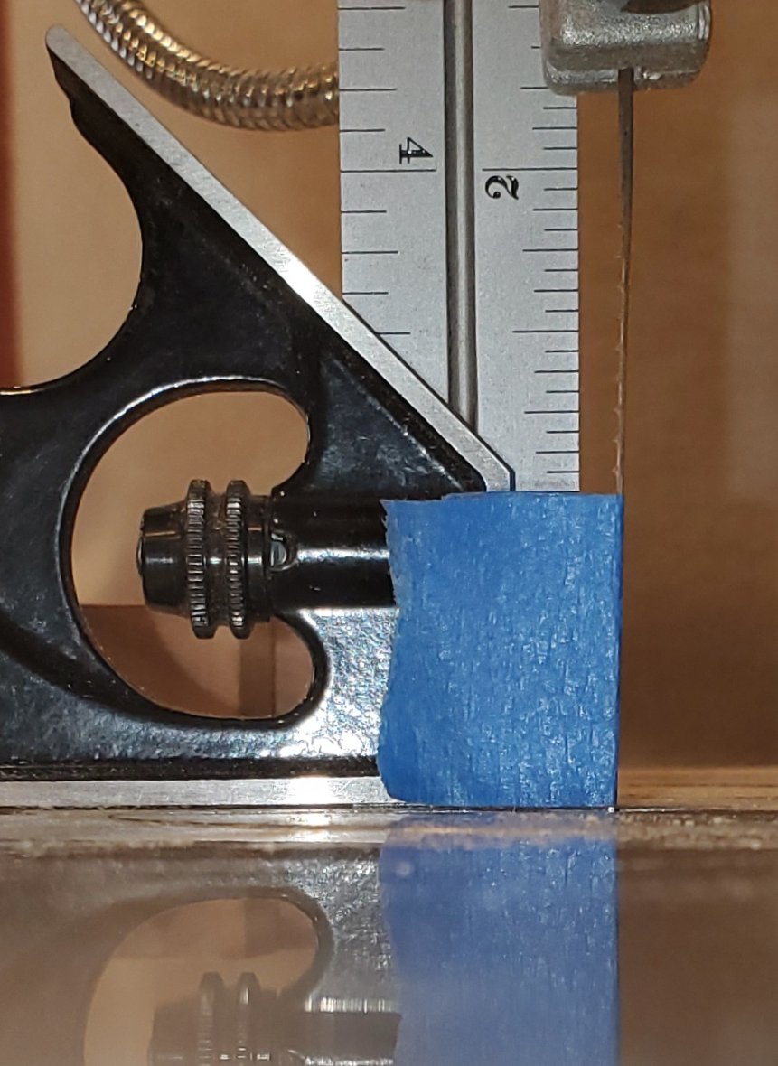

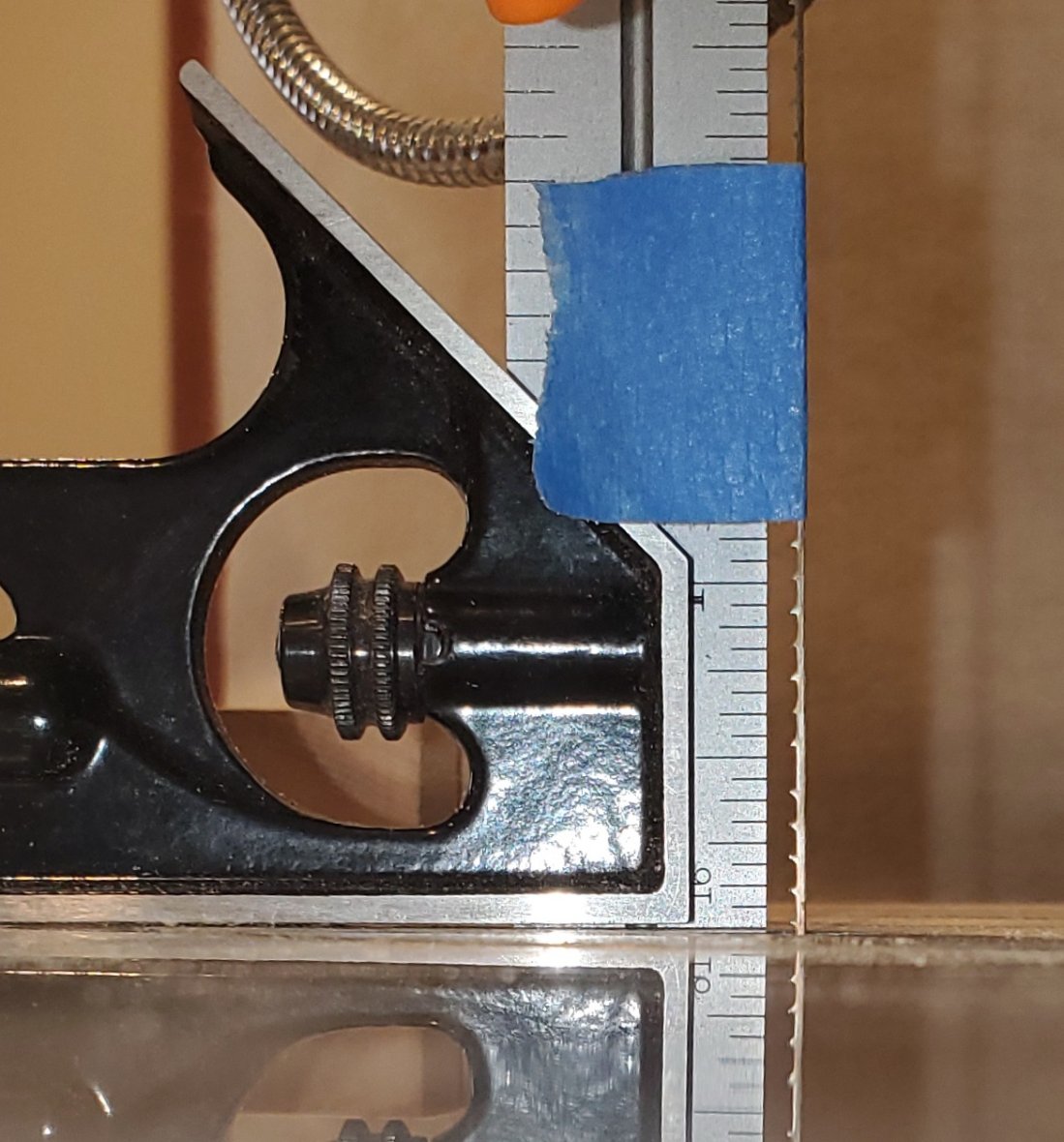

My saw, which I believe to be one of the earliest made due to its "ball end" tensioning rod, measures a stroke of 1 3/16".

Can anyone with a Teal or later grey scroll saw verify these numbers?

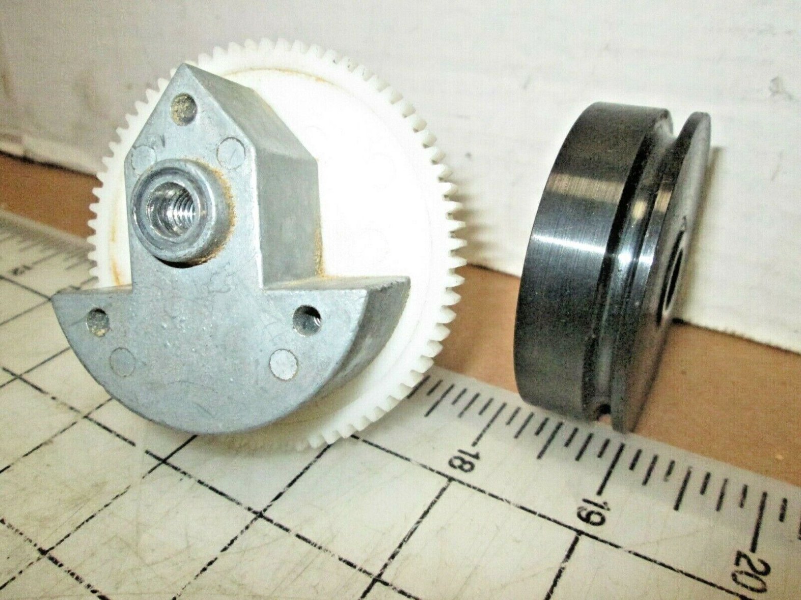

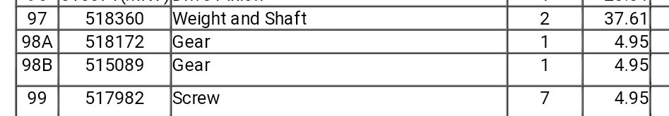

Some possibly supporting data: The part number for the weighted cam, which determines the stroke, changed between the grey and teal versions.

Mine is the self-powered 555272 and the stroke is the 1 3/16" in the photos above. (I suspect mine is supposed to be 1 3/32" and the extra 3/32" is due to manufacturing tolerances)
Also, the manual for my saw has parts lists for both stand-alone and Shopsmith mounted. The part numbers for the relavent parts are identical.
And the 7/8" stroke is specifed for the Shopsmith-mounted teal model. https://www.shopsmith.com/ownersite/cat ... ollsaw.htm

i toyed with buying a cam and shaft from a Teal model just to see how if it would work in my older saw, but it appears the part is significantly different, and the chances that it would balance with the other weights is slim -- and buying both is richer than I'm willing to go. By my measurements and calculations the functional difference would be the pivot hole being approximately 0.09" closer to center than on the grey models.
Teal saw, counterweight/cam:
