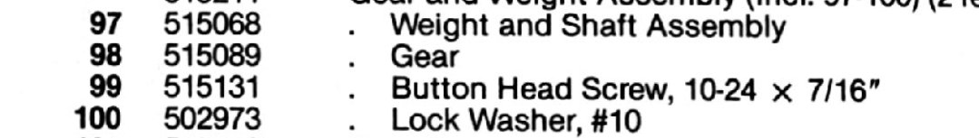

i toyed with buying a cam and shaft from a Teal model just to see how if it would work in my older saw, but it appears the part is significantly different, and the chances that it would balance with the other weights is slim -- and buying both is richer than I'm willing to go. By my measurements and calculations the functional difference would be the pivot hole being approximately 0.09" closer to center than on the grey models.
Teal saw, counterweight/cam:
