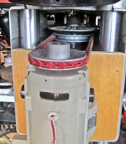

More progress: installed a 4.5" pulley on the idler shaft to prevent the link belt rubbing on the way tubes:
[ATTACH]20532[/ATTACH]

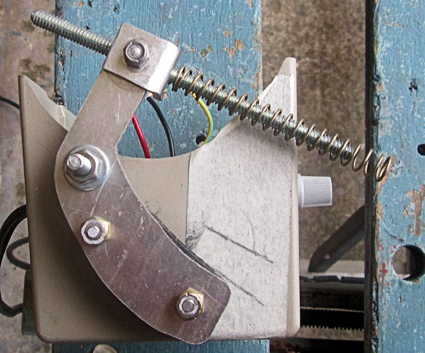

Made a swing arm to carry the magnet past the pickup:
[ATTACH]20533[/ATTACH]
Those marks on the tape mark fully on in the speed range and totally off (upper mark) so the arm does not swing much.
[ATTACH]20534[/ATTACH]

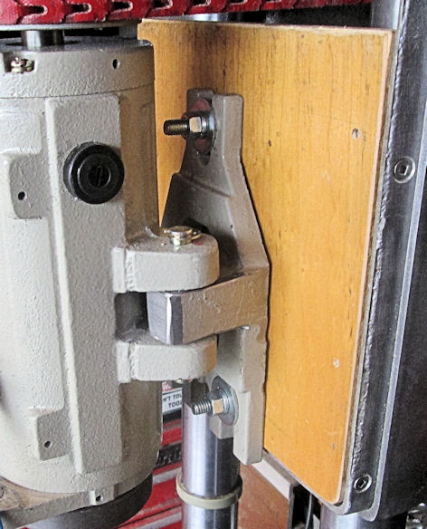

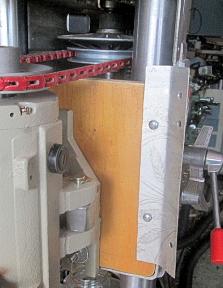

Moved the motor up a inch on the suspense casting by drilling a new hole and cutting the end off:
[ATTACH]20535[/ATTACH]
EDIT: I moved the motor up enough that the original motor pan might be reused provided a hole was cut to clear the brake wheel on the right end. I have not pursued installing the pan further as yet. Besides, it looks better with the motor snugged up!

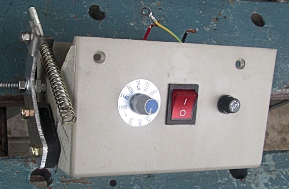

Made a bracket to mount the control box (cut out of an old aluminum serving tray):
[ATTACH]20536[/ATTACH]

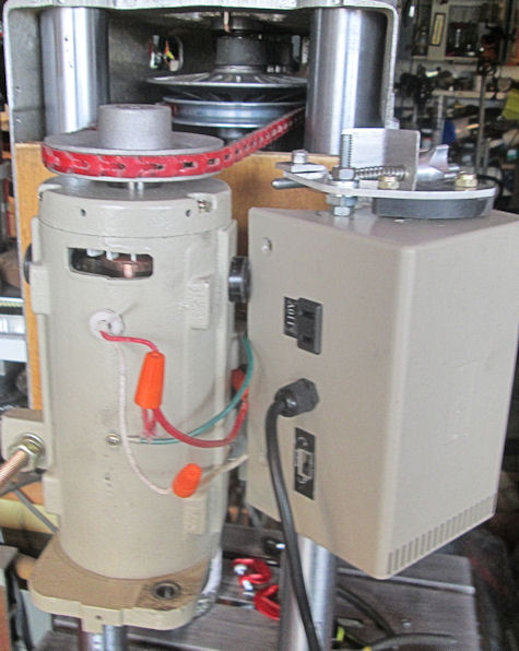

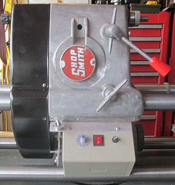

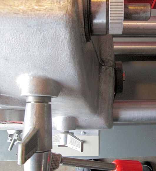

Mounted the control box and hooked up the ground and power wires:
[ATTACH]20537[/ATTACH]
Does put the reversing switch in an awkward location.
Lowered the SS into the horizontal from vertical where I had been doing all the work to find the control box just touches the way tube
totally good luck, not by design! It could have hit the way tube and required changes to the bracket. I put the Shopsmith access hole cover on temporarily to cover the speed dial hole.

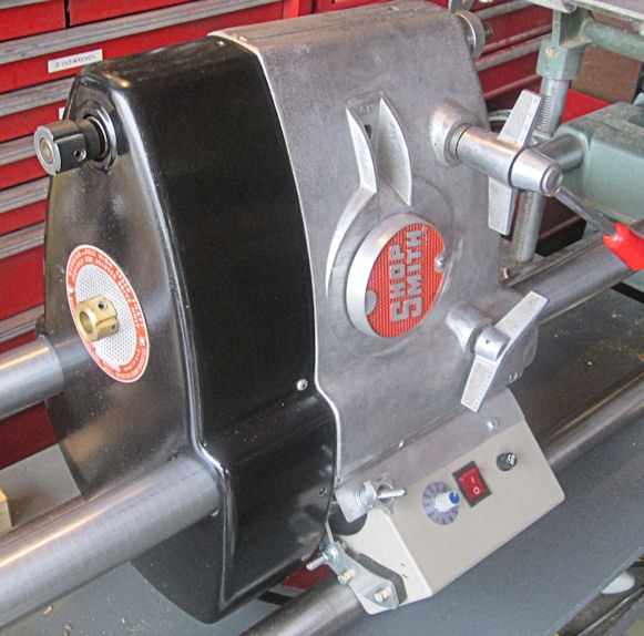

[ATTACH]20538[/ATTACH]
You can see it does not look too bad in this view:
[ATTACH]20539[/ATTACH]
I have not done anything yet about sawdust being sucked into the motor.

I plugged it in and turned it on. Seems to run nicely with excellent control within a speed range by turning that aluminum star wheel on the swing arm. I have not had time to run the SS as a table saw (or in any other mode yet) but it seems powerful. I also have not yet related the speed settings to the usual SS settings. I think the low end will likely work great but the top speed of 3450 rpm may be a problem (original went to 5200). I will post more soon.
