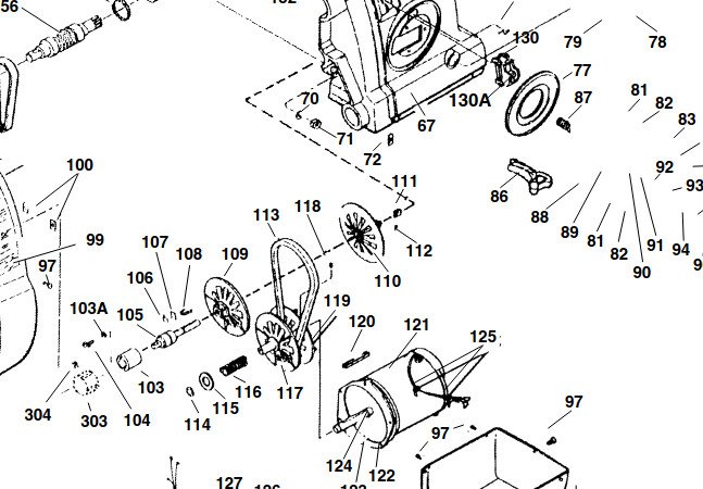

My Shopsmith did a similar thing a couple of months ago. The speed was creeping up as it ran, but I could also hear a clicking sound inside it. I shut if off, pulled the plug from the wall, and removed the side cover. Then, when turning it slowly by hand, I could hear the clicks and see uneven movement in the control sheave. The small bearing in the end of the control sheave was bad. I replaced the bearing and it is quiet now and no longer seems to creep. Yours could be an entirely different problem, but some visual inspection might show you the problem. The bearing I replaced is in the end of part 110 on the diagram.

I think you might be on to something there.
If the end of the control sheave is missing or has a damaged bearing and 'button' the porkchop might be experiencing pressure greater than 'normal'.
