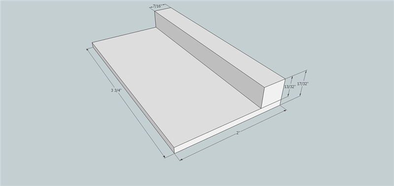

You can always make one. The only dimensions that are important are the 13/32" x 7/16" dimensions. The others can be modified to suit yourself.
This sketch (in Paint) provides all the details.
[ATTACH]15393[/ATTACH]
Setup and Alignment Gauge (Custom).png (48.09 KiB) Viewed 1520 times

dusty wrote:You can always make one. The only dimensions that are important are the 13/32" x 7/16" dimensions. The others can be modified to suit yourself.
What is critical re the 7/16" dimension? Methinks the 13/32 is the only concise one.
JPG40504 wrote:What is critical re the 7/16" dimension? Methinks the 13/32 is the only concise one.
It is maybe an overstatement to call it "critical".
dusty wrote:It is maybe an overstatement to call it "critical".
I think the 7/16 can be anything within our ability to 'handle' it. 1/2,3/8,5/8,3/4 . . .
