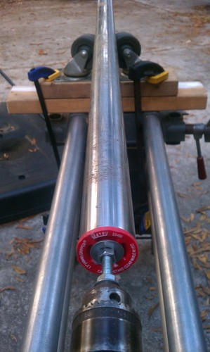

How about a summery, I use Nova G3 chuck with tape on the tube so it was not metal to metal contact with the chuck jaws, I also put tape as a reference to show how deep in the chuck the tube was. If tube would have started to work its way out I could visually see that and save myself some fun playing with a loose tube.knottythumbs wrote:Great Post. Please share details of how it's clamped and materials/process used to get these great tubes
The "tail stock" I think I went in to enough detail on but it is just a old piece of plywood with a "V" notch and lubed with toilet bowl wax.
For the sanding I used scraps of emery like sandpaper in a downwards direction along the top of the tube, running from tail stock to headstock. The shopsmith was running at 700 rpm. If you were to work on the underside it might lift the tube our of the V notch.
I started course and went to fine, I can not tell you grits as these strips had no numbers on them. I made no attempt to reduce the tube size to get all the pits out. I did use a wire brush to clean the pits of rust.
After cleaning the tubes of dust/gunk/rust I then waxed them with J's paste wax a couple of time, used the lathe for that function as well.
Still willing to answer specific questions if you have them.
I saw on the Forum a picture of someone using a 3X21 belt sander for cleaning caster rods. I quickly found my 3X21 belt sander and starting with course grits worked my way quickly to 220 grit using my Shopsmith tube cleaning Shopsmith. This did a beautiful job in a lot less time.
A caster wheel on each side of the "V" notch might work well. I mounted the caster wheels on each side ot hte tailstock as the 1 3/4" tubes will pass through the eccentric mount hole. I drilled a slotted hole 45 degrees off vertical on each side for the caster wheel bolts. The wheels are adjusted to just allows the tube to clear the tail stock. I mount the caster wheels on the opposite/back side of where the eccentric mount goes into the tailstock so the tail stock is still fully functional. I am unable to do tubes that are bent very much due to excessive vibration at 750 RPM. Sometimes I am able to salvage a MINI tube from the unbent part but most are saved for salvage yard.

reible wrote:How about a summery, I use Nova G3 chuck with tape on the tube so it was not metal to metal contact with the chuck jaws, I also put tape as a reference to show how deep in the chuck the tube was. If tube would have started to work its way out I could visually see that and save myself some fun playing with a loose tube.

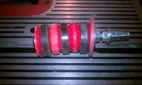

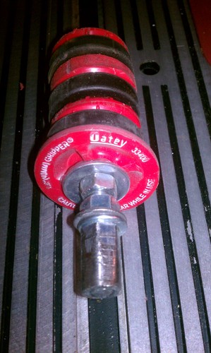

Thanks, here's my attempt
I couldn't find the plug Mr. Mayo used but managed to manufacture a usable plug. Here's some photos. My plug looks a little weathered after 4 tubes but is ready for the next 4 on my other SS.
