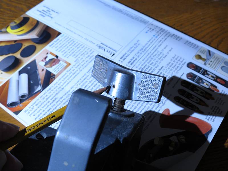

The 510 fence has two adjustments; handle and a knob. The knob (the picture says it is 241 and calls it a rollpin) turns a threaded rod which goes through the infeed clamp (239) and into a retaining ring (240). The knob has come off with the fence tight in place, so the fence is unmovable. I tried turing the knob back on but it does not go on tight enough to be able to unscrew the threaded rod. I am thinking of epoxying the knob to the rod and, if I still can't unscrew, then blasting it with WD40. Any better suggestions on how to free? Thanks, Jim

It sounds like you have broken or missing rollpin (241). The Knob that turns doesn't seem to have a number ???. How this works is that the knob is threaded on to the shaft. It is then aligned with the hole in the shaft and the rollpin is inserted through the knob and shaft. This is what prevents it from unscrewing.
With the knob off you need to look through or attempt to look through the hole in the knob and see if piece of broken roll pin is still in the hole or not. You can also check the shaft for a broken piece. If you can see through then screw the knob back on until you can see through the knob and the hole in the shaft. For now you can use a small nail through the parts and turn the handle to get the fence off the machine.
You will need to get a new roll pin, either shopsmith or maybe a hardware store if you can find the old one to measure...
Here is a picture of the hole in the handle, just to the right of the lead.
