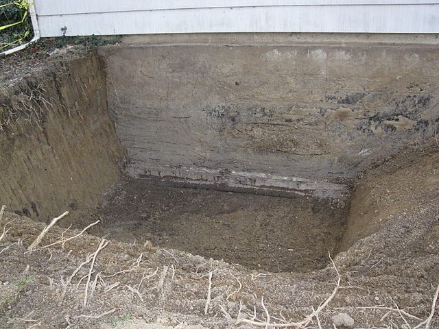

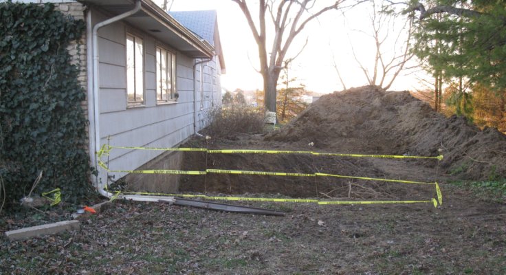

Finally got back to the "hole" for the basement woodshop this weekend. I've been running a little slow since the stupid fall. Healing but still a lot of pain in the shoulder.
Our son brought home a mini-excavator again and started on it Saturday evening and finished up Sunday morning. With the excavator doing the work and decent weather we went ahead and dug the whole little walk-out. The "hole" is about 8' deep and about 14' wide at the bottom and extends out from the house about 11'. That doesn't count the slanted side wall area. The top of the hole is a good bit bigger. I decided to make one wall almost vertical so I can get close enough to the door for hoisting loads with a tractor loader or lift boom. It will get a concrete block wall that will slant slightly back as it goes up. The wall that is parallel to the house will be block about 4' up then the upper part that slants back at about a 45 degree angle will be just laid with flat flagstone. The right side is all at about a 45 degree angle and except for the stairway will be laid with flat flagstone. The bottom will be fairly deep compacted crushed limestone after I get some more drain tile installed.
The door into the basement will be at the left side of the hole near the more vertical wall.
There is enough fall away from the house that with the top of the hole beveled back I will be able to be in the basement and see across the yard and through the trees through the window in the door which is what I wanted.

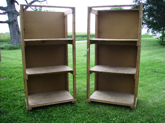

I finally got the 2 old roll-around stands that I originally bought at and for a flea-market where we used to keep a booth, emptied off yesterday and moved them in the truck as far as the patio where the old entrance to the old basement is.
(I think that this picture is 2 years old)
[ATTACH]15640[/ATTACH]
Today I told Diana that as soon as I got them down in the shop I was going to cut about the top 2' off of them because they were well over 6' tall and I didn't want or need them that tall. She thought a second and said "Why don't you cut it off out here so they will be easier to move down through the old basement?"
I knew there was a reason I picked her out of a crowd 50 years ago...
