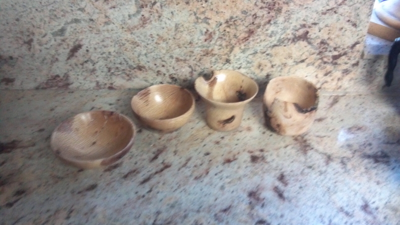

These have been sitting my shop for over a year and I finally found time to finish.
Turned from leftovers from a neighbors live oak blowdown.
Initially turned Green then left to dry in paper bags.
[ATTACH]15710[/ATTACH]

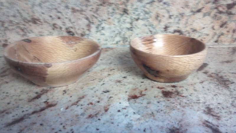

Bowl 1 shallow bowl, I use for holding my keys finished in CA (a lot of CA, this was an expensive finish I iwll not do on bowls again)
Bowl 2 I'll use in the shop as a spare parts bowls finish is spray on Poly
Bowls 3 and 4 have a bit of natural edging and occlusions from knots
Bowl 3 is finished in spray on poly
Bowl 4 was cleaned off with mineral spirits allowed to dry overnight and waxed.

Bowls 1 and 2 a bit closer

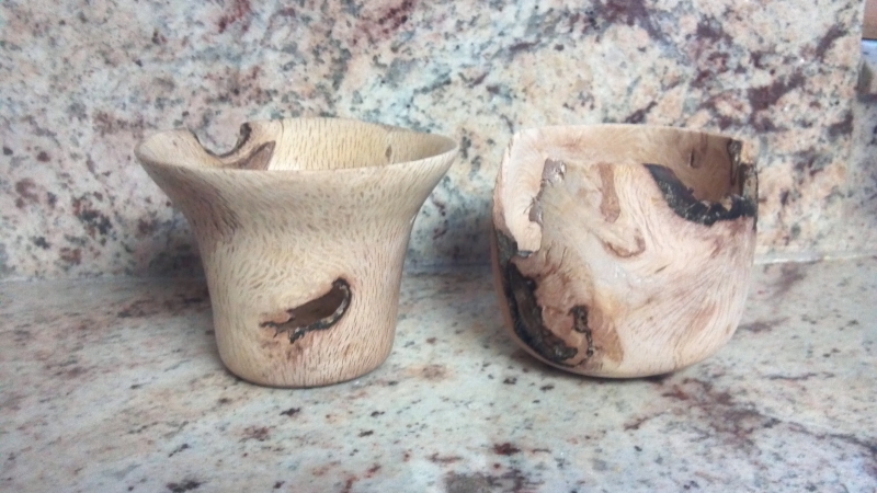

Bowls 3 and 4 a bit closer.
Bowl 4 was supposed to be taller with more natural edging but it kept chipping away during final turning.

Quite nice! How did you mount the blanks? Face plate? Chuck?

I love bowls 3 and 4 ! awesome work sir.

face plate with glue chuck.
I got a scroll chuck with some 8" flat jaws for christmas and used that for finishing the bottoms on 2, 3, and 4.

Thanks. Bowl 4 I like the best, I just wish it had come out as planned. It was about 1 1/2 inches taller and tapered back in towards the opening like a goblet. The opening and edge would have been about 3/4 natural edge would but as I was sanding, it just kept breaking apart; clean up with the sew, a bit more comes off, edge looks wrong etc. etc. Finally I just decided to quit while I still had something left clean and wax it for the more natural finish.
