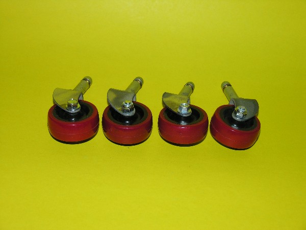

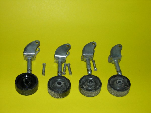

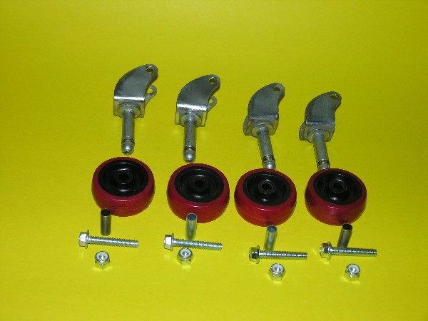

Paul and all who are interested,
Here are the parts I use to repair SS caster wheels with pics of a set I did today in about 30 minutes.
1. 2" wheel with steel bushing
2. .25"x20x1.5" flange bolt
3. .25x20 nyloc nut
ldh

What's a good way to remove the old wheels?
Jim
paulmcohen
Posts: 1577
Location: Beaverton, Oregon
Post by paulmcohen »
jmoore65 wrote:What's a good way to remove the old wheels?
Jim
Same question I was just asking, I thought I would drill out one side. Second option is use a screw extractor to drill out one side.
Angle grinder is third option but I don't have one.
Paul Cohen
Beaverton, OR
ldh
Posts: 430
Joined: Sun Sep 10, 2006 6:09 pm
Location: Phoenix, AZ
Post by ldh »
Paul,
Just use the side of your grinding wheel to grind the old axle down to the point that you can take a drift and knock it on through. It should take only a minute or two as the original axle is fairly soft. Use gloves when grinding as it can get a little warm. As I said in an earlier post it takes about thirty minutes to complete a set of 4 and have them back on the SS.
ldh
Use your 12" sanding disk on the SS if you don't have a grinder. It probably will work better than the grinder anyway.
paulmcohen
Posts: 1577
ldh wrote: Use your 12" sanding disk on the SS if you don't have a grinder. It probably will work better than the grinder anyway.
I am trying really hard not to remove the casters, I just put a small piece of wood under one end. I have easy access to the casters.
I would have done it already but have been sick for three days with allergies or a cold, all I want to do is sleep.
Paul Cohen
Beaverton, OR
ldh
Posts: 430
Post by ldh »
Paul,
In all honesty I think you will have better luck if you remove the casters and work with them on the bench. You can pry them out with a large screw driver then when you put them back into the cam a small amount of grease can be placed on each caster stem to help with the reassembly. I don't roll around on the cement like did once so I don't spend any more time repairing things on the ground than I have to. Have a good nights rest and it will look better in the morning.
