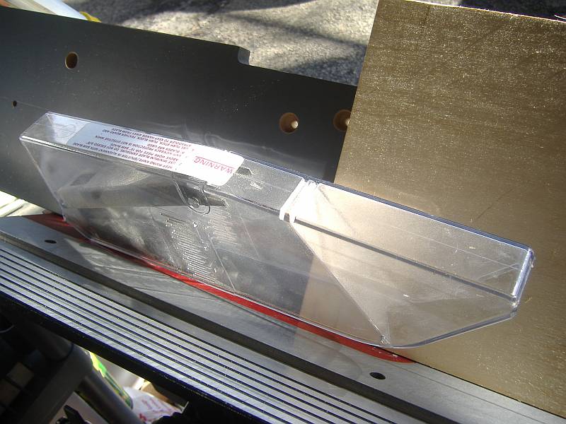

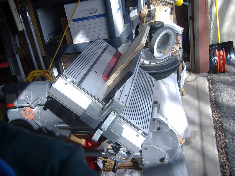

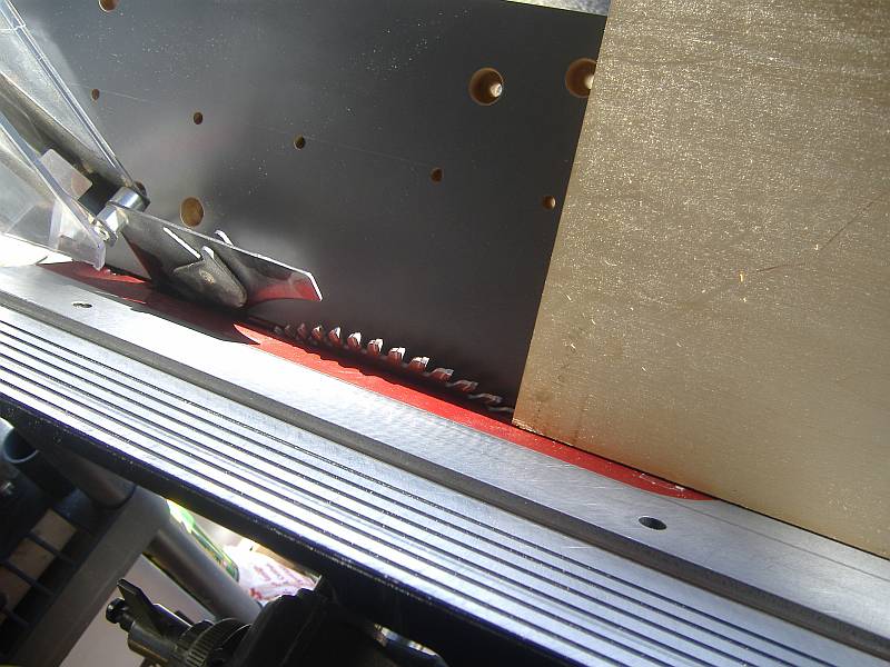

Seems that this is rather a simple thing to do, you just need to think a little differently.
Board flat on the tilted table, board vertical on the tilted table.
Keep in mind this is not a real set up to cut the wood, just a way of showing how it might be done.
First you need a tall fence, this you can make on your own to fit the 500 rip fence and using the holes in the fence to mount it.
The edge of the blade nearest the rip fence should just leave the very edge of the workpiece, perhaps a 32nd left which you can later touch up by sanding.
You will need a out feed table or support set at the proper height to support the workpiece as it leaves the table, say 3 feet away.
If you have the guards you will have to check for fit, it works on the 520 but the 500 is a little different, it is best if you can as the splitter if helpful on this sort of cut.
Pictures please? Sure.
[ATTACH]15974[/ATTACH]
[ATTACH]15975[/ATTACH]
[ATTACH]15976[/ATTACH]
