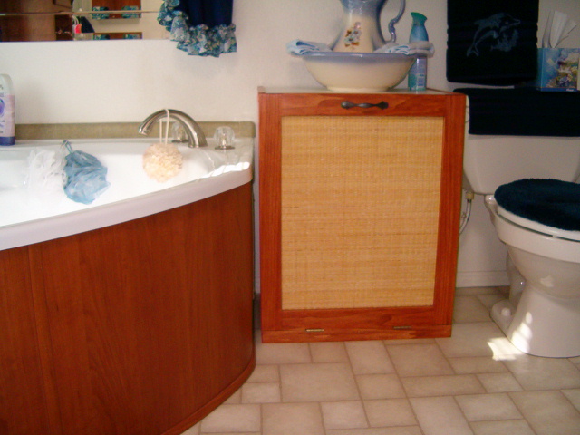

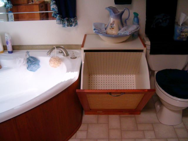

Funny you mentioned a veggie bin. Although my shop weed was limited by weather, I had a chance to repair the front (cain)of our laundry bin. Thought I'd attach a couple of pix it it will give you an idea if you aren't working from plans. The simple stops I designed consist of hard faucet washers attached to the case side and shortened 1/4" bolts to hit on the washers. My bin is made from 3/4" melomine board case with 1/2" hardboard bin sides and peg board back and bottom.. There is an open back on the case, except for braces to allow for air circulation.

Chuck- nice laundry bin- great design and I like the color combination too! Do you weave the cane as well or is it commercially available?

That's a nice piece for a laundry bin, ours is just a plastic pail. I'm surprised the wife hasn't asked for a more deluxe model so I wil NOT show her this picture.

Hi Gary - Thanks for your comment. I didn't think this is anything special, it's just a box without a solid back and a tilting bin. (I think the cute part is the opening stops) However it is pretty functional.greitz wrote:Chuck- nice laundry bin- great design and I like the color combination too! Do you weave the cane as well or is it commercially available?..."

My wife wanted a larger bin than the old store bought one. The colors had to reasonably match the rest of the bathroom. I chose poplar for the front and mixed a little cherry stain with maple to get a color that was pretty close to the 'apple' colored wood in the room. At least 'apple' is what the manufacturer of the cabinetry calls it.
The cane was purchased from Rockler in an 18" wide roll. My wife OKed this. The bin door was made to accommodate the 18" cane mat. My original design failed in about a year. I had made the bin front like a window with 3/8" by 3/8" rabbet to hold the cane. - Made quarter round to nail down and secure the cane. Eventually the cane pulled out from quarter round in several areas and made the thing look real sloppy. The reason it came loose was most of the brads didn't pass trough the cane
The new fix (last week) was to make a frame to fit the rabbets. This frame has mortise/tenon joints and is 1 1/4" wide. Then after steam ironing the cane, and flat drying it - I glued the cane to the full diameter of the frame and when glue cured, sanded off any cane that protruded from the edges of the frame. Then nailed in the frame using a pneumatic brad gun. Now the one in this house that counts is happy! There's no elation from my bride about fixing something that I poorly designed in the first place. Just "it's about time!" However, I can take pride in being able to figure out a fix.
Thanks for the details, Chuck! Your bin looks a lot classier than the Rubbermaid ones we use. I guess I'm lucky in that my wife doesn't care how the hamper looks as long as I manage to get the clothes in there.
But I don't think using cane is in my future- steam ironing it? I think if I used the iron on anything other than fabric, my wife might show me a different definition of "caning"!

Every well equipped shop needs an iron. I have had and used one for years and years. FYI if you print an inverted image on to a laser printed page you can refix the toner on to a smooth piece of wood using an iron... handy. If you happen to get an old one like mine that is heavy it works well to hold things down... the iron and a spray bottle of water makes a usable steam iron... works well to raise dented wood areas... the list goes on.
My wife ironed it for me! I'm not allowed to touch her iron! (:eek:disaster!) - and don't want to! It is one of those irons that has a tube connected to it that runs up to a one gallon container of water hanging from the ceiling.greitz wrote:...But I don't think using cane is in my future- steam ironing it? I think if I used the iron on anything other than fabric, my wife might show me a different definition of "caning"!

However ED the Knight has spoken the truth. Used to have an iron in my shop in Montana. That was an old flat iron that was heated up on the wood stove. Glad I didn't move it across the U.S., but have to get another. Probably a more modern one.
