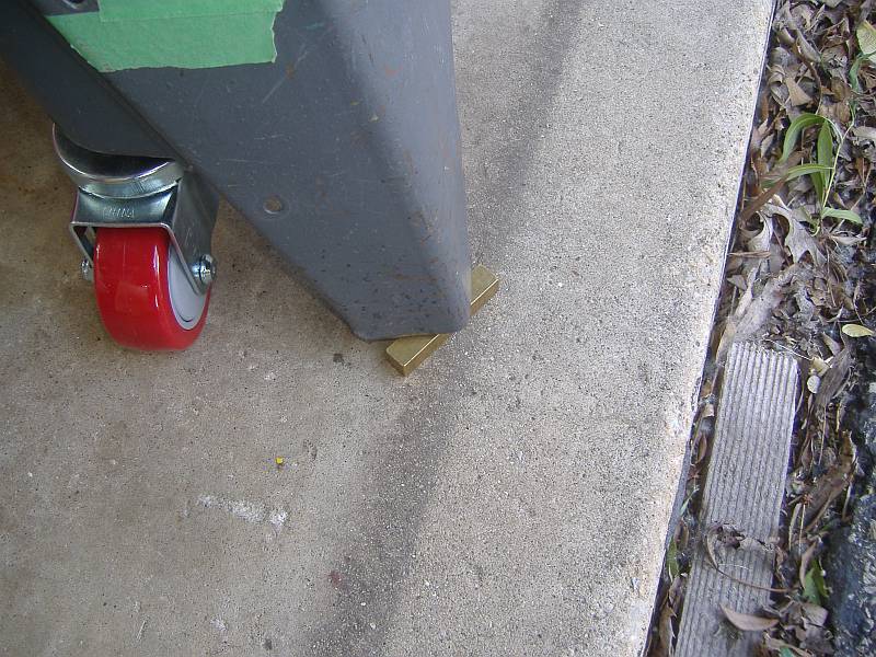

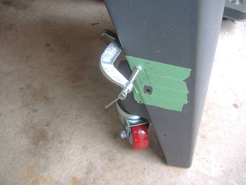

Started the new round of testing to see where the casters should be mounted. The template I have shows the holes moving 1-3/4".
I clamped the casters in that position and was not happy. The wheels are off the ground in the lowered position such that a 1/8" bar fits easly but a 3/16" would be a tight go.
When in the first step position it's just off the ground, I started at 1/4", no go, nor would a 3/16" bar. I couldn't even get the 1/8" bar to fit.
Second step no where near the 1/2" I'd like to see, the 3/8" bar would not fit but the 1/4" was a loose fit.
My back is worn out for the day but I want to check this out to make sure the clamps are indeed still holding where I put them and second to check to see I marked the places correctly. Glad I didn't start cutting metal yet.
I'm thinking of moving down 1/4" if I find my current setting were right on. (This would be a change to 1-1/2".)

Dusty- The instructions for the caster set upgrade include a paper template with circles drawn representing the "old" holes and the "new" holes. You're instructed to position the template by sticking a sharp pencil through the center of the top "old" hole in the template, then put the pencil tip into the old hole on the leg, and tape the top end of the template in place. Repeat the process with the bottom "old" hole. Then the "new" holes can be marked with a punch and drilled.
There can easily be 1/4" or so of slop in the positioning of the template using the "pencil" method, and that may be part of the discrepancies in height being discussed here on the forum. I'm sure the "low" position on my upgraded casters is significantly less than 1/4" off the floor. It doesn't bother me any, I always use the "high" position when I move the Shopsmith, anyway.

I verified that the clamping locations were per the shopsmith information and that nothing had not moved.
I then clamped the legs 1-1/2 higher then the original holes. Bar is a tight fit at 1/4" step.
[ATTACH]17159[/ATTACH]
Perfect at 1/2" and fully on the ground in the lowest setting just like I wanted
[ATTACH]17160[/ATTACH]

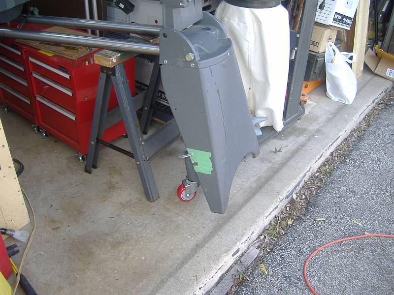

I decided I didn't want to be flipping the shopsmith around so I took off the legs, seemed to work well for me.
[ATTACH]17161[/ATTACH]
