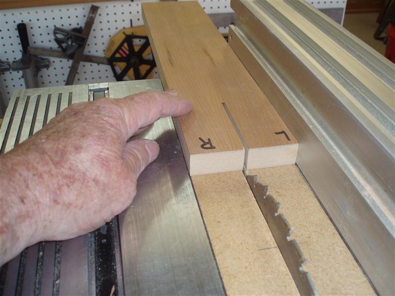

As always, there are multiple way to accomplish the task. Another would be as follows:
Rip a 15" piece of 3/4" or 1" stock to 3 1/16" wide. The width is critical because you want it to fit snug in the cutout for the table insert. The final length may be altered later.
Set the rip fence so that the left face is precisely aligned with the right edge of the table insert.
Make a short (1/2") rip cut in one end of the 3 1/16" piece. This is to be done with the piece held tight against the left face of the rip fence.
Flip the piece over and make a similar cut in the other side.
If every thing is properly aligned the two cuts should be precisely in line with one another.
With power turned off, make that same alignment check on the outfeed side of the blade. If the blade is parallel to the miter slots, the blade should fit smoothly into those short kerf cuts.

[ATTACH]17268[/ATTACH]
Align fence to edge of Table Cutout. Precision placement is essential.

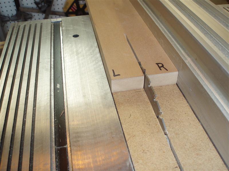

[ATTACH]17269[/ATTACH]
Cut a kerf into end of jig which is 3 1/16" wide. Must fit snugly into Table Cutout. Added Comment: 3 1/16" " might be a bit much. If it is shave it down to approach 3 1/32".

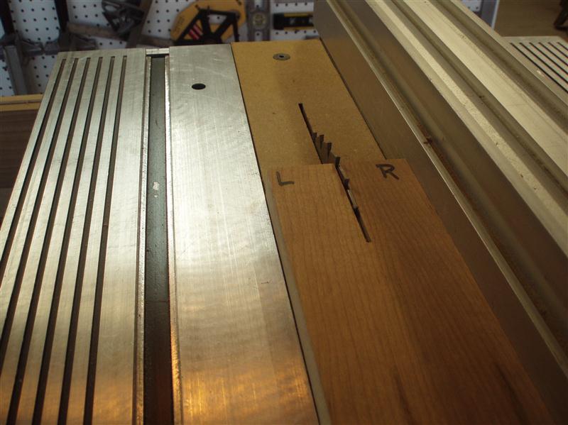

[ATTACH]17270[/ATTACH]
After making cut, check for non-interference fit on other side of blade. A smooth fit indicates that the blade is parallel to miter track.

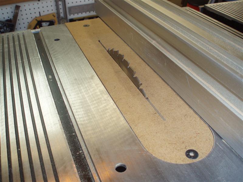

[ATTACH]17271[/ATTACH]
Flip jig over. Note left/right markings. With jig against the rip fence, it should fit (non-interference fit) onto the blade. A smooth fit indicates that the blade is centered (left/right) within the Table Cutout. Interference, which I have, indicates that the table is not perfectly aligned. Mine is off about 1/32". I can force the jig into place but it drags on the blade.

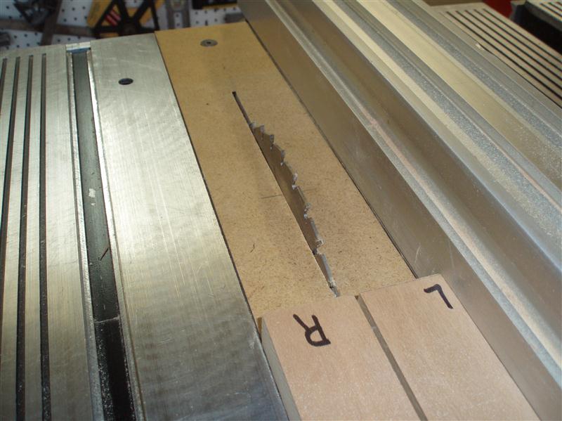

[ATTACH]17272[/ATTACH]
At this point there is no real need to repeat the test on the other side of the blade but doing so sorta confirms previous conclusions.
The blade not being centered in the cutout is really not an issue of any sort. Only someone who is "over the top" on precision would even notice.
The jig that is shown here is cut to fit firmly in the Table Cutout. Mine measures 3 1/16" wide.
Table Alignment Jigs 001 (Custom).JPG (77.91 KiB) Viewed 3880 times
Table Alignment Jigs 003 (Custom).JPG (69.82 KiB) Viewed 3882 times
Table Alignment Jigs 004 (Custom).JPG (74.05 KiB) Viewed 3882 times
Table Alignment Jigs 005 (Custom).JPG (72.42 KiB) Viewed 3885 times
Table Alignment Jigs 006 (Custom).JPG (67.76 KiB) Viewed 3882 times
