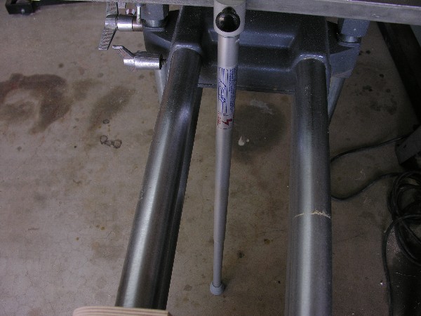

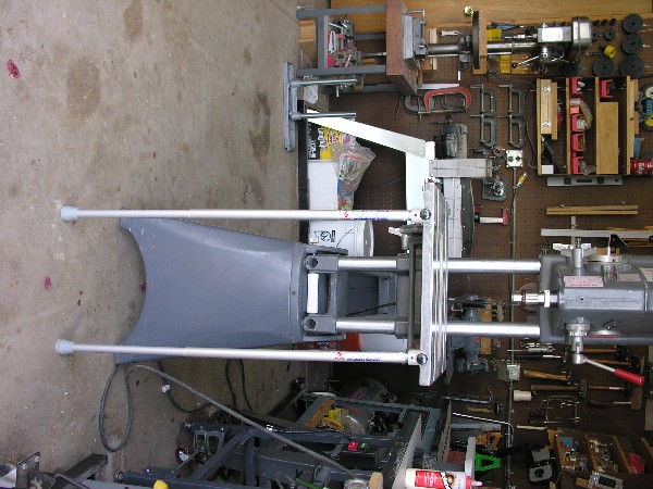

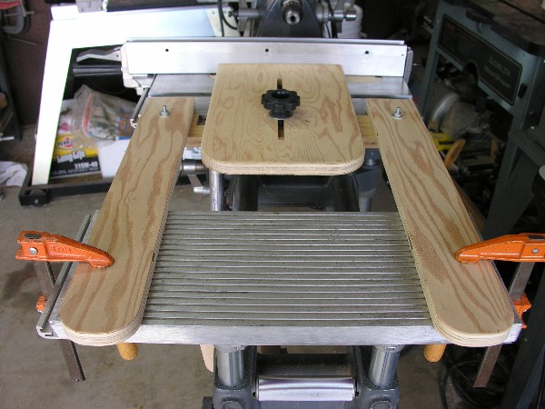

Blackace,
With the Mark V 500 you can use the SS #555627 support legs with your table. I will post a pic of using them on my 500 along with a simple jig that will
address any creep in your carriage as well as preventing any creep in your fence when drilling tough material.

Having read all the posts on the hole depth problem it is clear that many have experienced the tricky little problem and have quickly solved it with tightening or cleaning some adjustment on the Shopsmith. I find that my inattentiveness or lapse in thought process created the same problem many times. I think the Shopsmith is just about the best all-around woodworking tool that money can buy. The attached pics are of a simple jig I use to keep any possible creep out of my table and fence when I am using the machine in the horizontal boring position. The use of the Shopsmith #555627 legs are of great help also.
ldh
