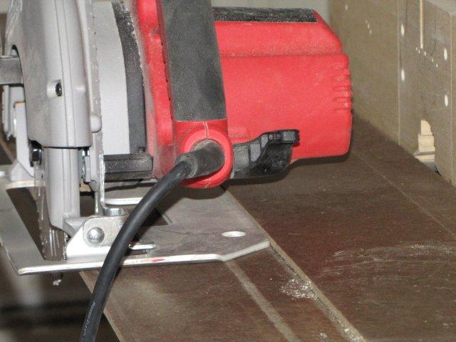

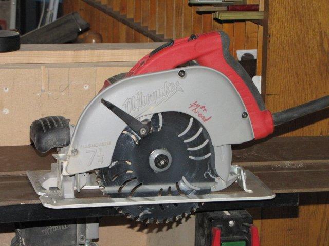

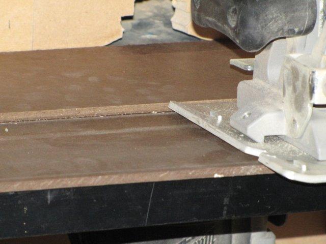

Poor man's version of a track saw
1/4" hardboard. No, it's not a Festool plunge cut, but works extremely well to cut down sheet goods to manageable sizes. and I don't have much $$ tied into one 5-footer and another 8-footer.pinkiewerewolf wrote:I think SS has the answer to the RAS and the "chopsaw, sliding compound chopsaw" etc... for those that don't want to have another dedicated tool in their garage space. I bought one of these systems a few years ago (before SS came out with theirs) and it is useful for cutting about any cut you can think of, and you can use the edge for routers, etc...

The home-made version does a couple of things for me:pinkiewerewolf wrote:That method works but there is a couple advantages to the track system. A good system allows you to align the system to your cut line w/o measuring for saw kerf and other variables, after your initial set up. You don't deviate from your line, ever. You're locked in. The inserts that allow for a tear-out free cut on finished products.

1. No measuring or allowance for the kerf width. Position the edge of the 'track' on the keep side of the kerf....blade is on the waste side.
2. The edge of the 'track' provides for ZCI on the right side of the blade, reducing chip/tears, etc.
Even with a ZCI, and I don't care what blade or saw I use; I still run blue tape along the cut line. Once the cut is done, peel the tape on an angle so that the pulling action goes off the end.....pulling it so that it pulls into the wood can lift splinters from the cut edge. The paper thin veneer that is on today's plywood is extremely fragile. Hate plywood, but sometimes use it anyway. Also, always position the plywood so that the blade enters the 'show' side.....show side up on the table saw and band saw; show side down on the circ saw, miter saw, or RAS.
