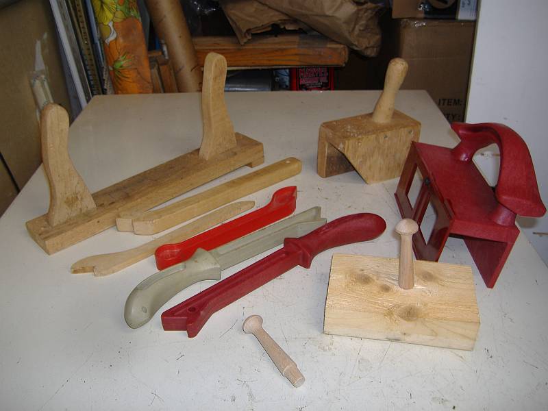

Hi,
Since I was in the shop today I picked up a few of the "push sticks" I have. A couple of them are from the old PTWFE, one is made out of an old wood hanger, and of course the shopsmith ones you will no doubt know about.
I also pictured a push block/backer that is useful for routing (that is the one with the wood handle sticking out, front right. I buy the turned bits and you just drill a hole and stick it in, when block of wood is chewed up you toss it and make another).
I didn't notice my half moon one that I like and another coat hanger special made from a larger hanger so they are not pictured. I have a D-handled and a few more specilised ones, they are easy to make and cheap... and you can make them to your liking. It is not uncommon to use more then one on an operation so it pays to have extras sitting around for when you need them.
Can't say I've ever felt the need to add any coating to them. But if it makes it safer for you then great. I don't get Wood so maybe someone can report back a summery???
[ATTACH]1029[/ATTACH]
Fence Stradler
I'm surprise no one has mentioned the Shopsmith fence straddler.
I don't have a Gripper, but do use the Shopsmith Fence Straddler quite a bit, for both narrow and wider rips. Actually, anything under about 3". With the saw guard in place, it will push 3/8" rips very nicely.
