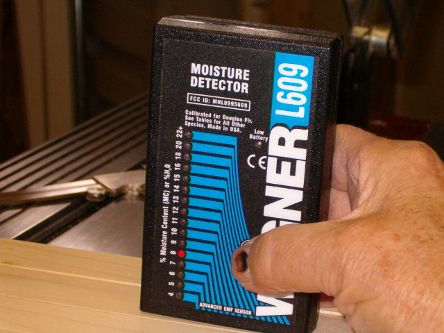

So using the pinless moisture meter, (This is a wonderful tool - every one should have one) I rationalized it is dry enough! The moisture in the wood varied from 8% to 11%. Sorting the boards to select the driest ones, then sorting again for color, cut (rift, to flat) and grain, started cutting slightly over sized boards for the pieces. Today, all pieces except those for the top(s) and shelve(s) are sized and sorted. They are all 9% MC or less.
Now for what I think is the interesting (confusing) part. Most of the un-cut lumber sits at 9% to 10% MC. This is pretty good for new bought lumber. However I have found pockets within boards that are holding more moisture. So once again we realize lumber is produced from trees and is not uniform in structure, specific gravity and internal tensions. We should never treat it as mono structural. Machining it does not ever produce identical pieces. I can cut identical sized parts, but not identical pieces.
The thru tenons (from already sized pieces will be 3/8"X 4 1/2" and none of them quarter sawn. If the wood will get down to a solid 8% before cutting the tenons, I'm pretty sure there will be only negligible shrinkage when moved to Arizona. In the meantime, I plan to go ahead and make up the cross pieces with smaller (3/4") tenons. When trying to calculate the vertical movement of tenons when the rift grain is variable, I can only figure averages. To predict wood movement is pretty easy if working with either flat or quarter grained, it is pretty unpredictable with twisting, rotating rift grain. Most of the movement will be diagonal, across the tenon. Four inches + is a pretty wide tenon, even for a thru tenon. I plan to pin them for a little extra help. Hope it works.
Here is a photo of my moisture meter. This was taken a while back, on the shutter project.
[ATTACH]1022[/ATTACH]

Chuck,
I do not have a moisture meter.
After reading about them on this forum, I think that it is something that I should use. Is being "pinless" a good thing? Are they available pretty much anywhere or a specific type of store? Looks like you banged your thumb pretty good there.
Tim
Hi, Tim! Yeah! I think every serious woodworker should have a moisture meter. Using one is the only way you can tell how fit you lumber is to use. After all, a board at 15% moisture content doesn't feel any different from one having only 6%. Edge gluing these two will give you a very interesting step after a while. Some old timers will say the glue was the problem.
The meter I have is a Wagner L-609. It is about 7 years old and still on it's first 9 volt battery. When I bought it, I found it was the only one I could afford. Now it is sold by Rockler.
Meters with pins leave holes in the wood - something I didn't want to do to my wood. This one sends out a magnetic wave. Harmless they say.
I have used mine to detect moisture in Sheetrock walls, caused by a leak above a window. Also found the location of a water pipe leak in a concrete slab. These meters are not intended for those purposes however. Since the scale only goes up to 22% the wall pinned the meter.
The L-609 is set up to measure Doug. fir, so I have to use their tables (included with) to measure oak and poplar, and plywood.
