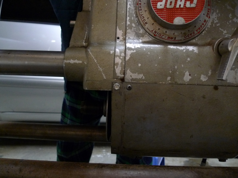

Here is the picture
please see the picture. :-)

It would not be wise for me to answer that question without knowing more about which specific screws you are talking about.
However, if cosmetics is all you are concerned with, I would suggest that you use screws with a common head type and not worry about the difference in size. Secure is what is important.
You could drill out all of the holes to a common larger size. My concern would be loss of structural integrity. Again, which holes.
You could use JBWeld to fill and cover all of the holes and when well cured, drill them all out to the original (small) size.
Some of the holes use tinnerman clips don't they? Or are the clips missing and someone chose to use larger screws?

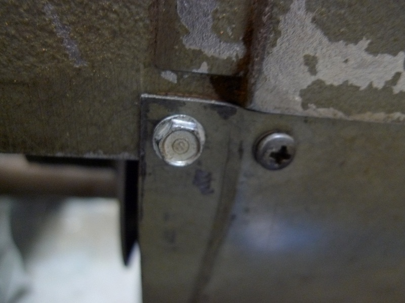

In your picture, it appears that the phillips head is an extra screw and the hex head on my machine screws into a tinnerman. That is the motor pan being attached to the headstock, correct.

it's the screws to hold the motor pan

I have not purchased tinnerman clips for several years but I would bet that ACE Hardware has them as should any large hardware store. Lowe's probably has them in their hardware section.cllib wrote:Thanks for reply.

To hold the motor pan securely, I would think that tinnerman (or similar) would be required. The casting would not produce adequate thread depth without some sort of clip. (My humble opinion)
Tinnerman clips are used in lieu of threads when installing screws into thinner metals.

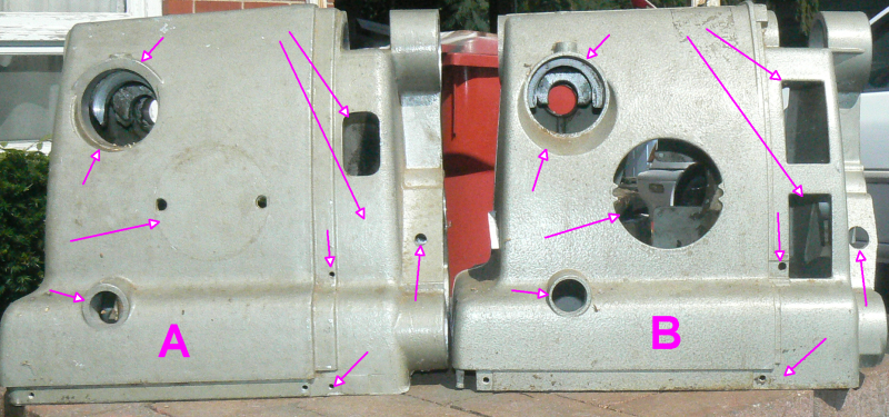

Does my A headstock use tinnerman clip?
It seems my A headstock use the screw to go into the casting without using the clip.
am I right?

What I have done, is attach a kep nut(ext tooth lock washer attached) and jb welded them in place(on the inside). On those holes with the original threads, I installed a screw, then threaded the nut onto the screw so the threads are continuous.
If the through holes have been drilled larger, a washer may be used to keep the screw head from coming through the hole.

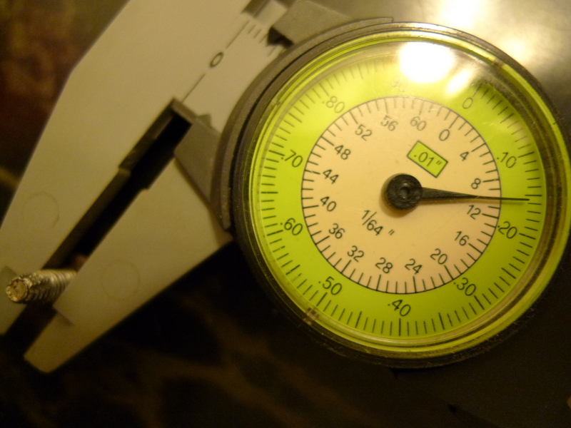

The original threaded holes and screws were 8-32.
I do not know what you are referring to as a '5/32' unless that is the screw head od.
5/32 meant the OD
and it's the same as the 8-32 screw.

That is an 8-32 self 'tapping' screw. Creates an SAE standard threaded hole.cllib wrote:and it's the same as the 8-32 screw.
Thanks for the suggestions.
Different from self 'threading' which resemble a sheet metal screw thread(course pitch).
