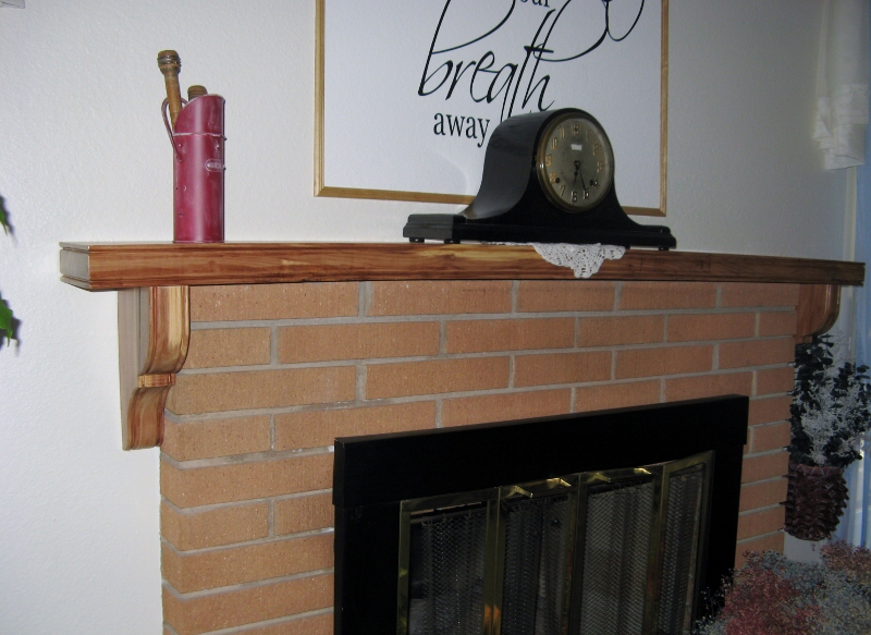

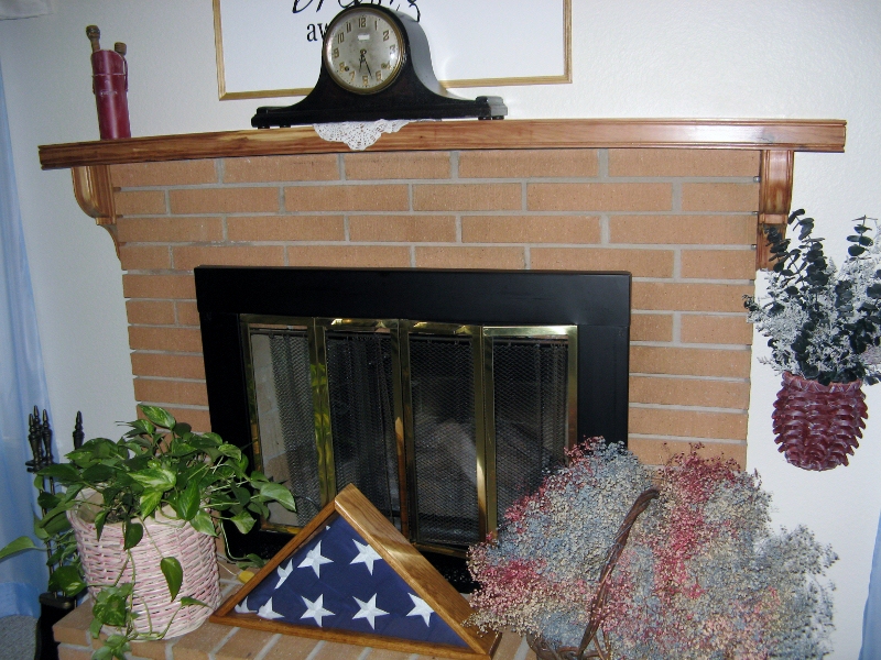

Two years ago SWMBO decided we needed a new fireplace mantle. I found a piece of what I would call aromatic cedar that was used on a abandoned corral. After cleaning it up on the planer it looked and smelled wonderful. I coated it with neutral stain and finished it with a water based clear finish (probably minwax brand). As you can see it has lost its vivid colors and is now brown and boring. I am not sure what the answer is but I do know It's not way I finished it.
[ATTACH]19266[/ATTACH]
[ATTACH]19267[/ATTACH]
It sort of soft remind me of cypress or western red cedar. Anymore with finishing tip
