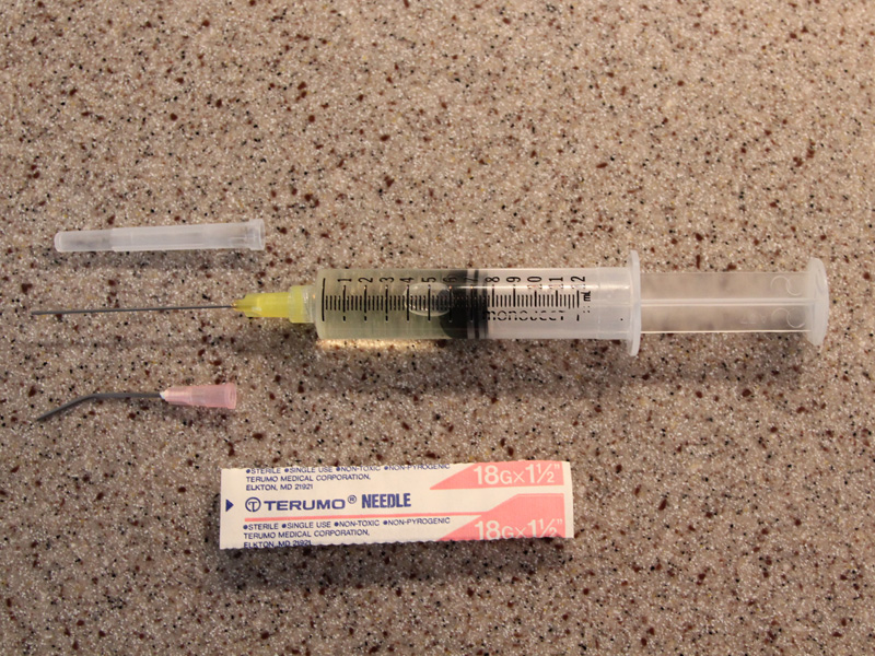

I have a "zoom spout" that I use. Here's an alternative: a medical syringe.
It's a 12cc (available in various sizes). The needles shown are 18 ga, 1 1/2" (pink cap) and 22 ga 2" (yellow cap). I use either gauge.
Most medical facilities will supply these. I got mine from my veterinarian. The needles will be sharp and are easily blunted with a dremel or such. The needles just twist on, so are easy to interchange. They are called Luer-Lock. These are very inexpensive,too.
I find the needles to be easier to use in cramped spaces, and easier to control the amount of oil. As shown, the needles can be bent...Re-load by putting the needle into the oil and pulling on the plunger.
[ATTACH]16679[/ATTACH]
Fred
