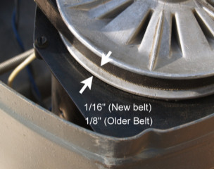

Dusty, sorry it took me so long to wade into this thread but I needed to gather some information from my factory snitches to be better able to answer you and they were unusually hard to contact. You'd think it was Christmas or something.
I gather from the thread that you've progressed from fixing the metalic sound yourself to having the headstock rebuilt. If the sound at high speed is really all that's wrong, you may want to think again. It's an easy fix.
The sound you're hearing is the control sheave rubbing on the speed control mechanism (indicated by the arrows in the photo below). As you dial in a higher and higher speed, the control arm pulls the control sheave away from the idler sheave. Ordinarily, a long, threaded allen screw stops the control arm when the speed is as high as it will go and prevents the arm moving the control sheave so far that it rubs. Occassionally, this allen screw loosens and the screeching begins.
[ATTACH]36[/ATTACH]
Remove the rear cover from your headstock and (carefully now, the protective cover is off) run the speed up to where the top surface of the V-belt is just below the rim of the drive sheaves, as shown in the following photo. If you have a new belt and its width is still close to 1/2", it should be 1/16" below the rims. If you have an older belt and the width is 15/32" or less, make it 1/8" below the rims. (If your belt is less than 7/16" wide, get a new one.) This is where your belt should end up when the speed indicator is on "FAST." By the way, Roland, this is also where the belt ends up when the machine is running at 5200 RPM with a broke-in belt. When the belt is brand new, the Shopsmith will only run at 4800 RPM. Try to adjust it higher and you'll get the screech that is ruining Dusty's holidays. As the belt breaks in, it stretches and narrows slightly -- and the speed of the machine goes up to 5200 RPM.
[ATTACH]37[/ATTACH]
Remove the Speed Dial with a 3/32" allen wrench and loosen the jam nut on the idler gear. You may find it is already loose -- this is what holds the allen-screw-speed-control-stop in place. Turn the allen screw with a 1/8" allen wrench until you feel it push against the control arm. (See photo below.) Hold the set screw with the wrench so it doesn't turn and tighten the jam nut.
[ATTACH]39[/ATTACH]
Reset the outer ring gear of the speed control mechanism so that the pointer on the headstock lines up with "FAST" on the ring gear. Replace the the speed dial. (See photo below.) Turn on the motor and run the speed control through the range of speeds several times. The screech should be gone and the dial should stop at "FAST."
[ATTACH]40[/ATTACH]
Oh, yeah. While you've got the rear cover off the headstock, suck out the fine sawdust and oil that puppy.

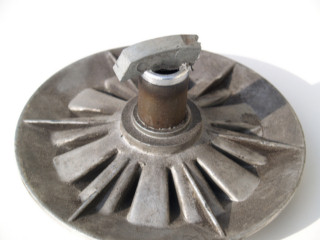

Albert, while my camera is still warm I thought I'd comment on your experience with the itty-bitty bearing in the control sheave. There is indeed one there folks, and it's not sealed. (See photo below.) Needs some attention and few kind words now and again. The lubrication you put in the hole in the control sheave shaft finds its way to the bearing and makes it feel appreciated. That's why we changed the maintenance instructions a ways back and upped the recommended dosage of oil from 2-3 drops to 5-6. Got a lot of warm, fuzzy thank-you notes from happy bearings for that.
[ATTACH]41[/ATTACH]
By the way, don't try to oil this bearing from the outside. The oil you leave on the surface will attract fine sawdust and wick the lubrication right out of the bearing.
Want to see what happens when you ignore this little bearing? The photo below is from the "Hall of Shame" where our rebuilders keep a few of the old parts that were subjected to extreme abuse. You're looking at a ruined control sheave in which the bearing froze and the coupler that hooks the control sheave to the control arm twisted off. The owner, whose head and headstock were both full of sawdust, kept on working! You think that the screeching that Dusty reported was annoying? Grown men weep at sounds such as this must have caused. In short order, the friction heated the control arm and it actually welded itself to the control sheave. The control arm broke off and the owner finally decided to quit.
[ATTACH]42[/ATTACH]
The moral of the story is that 5-6 drops of oil in the right place at the right time will go a long way to insure that you and your machine continue to work happily ever after.
With all good wishes,
