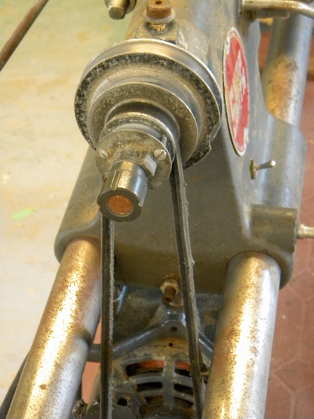

I don't have any SPT's at my shop in Canada where my 10ER is but this mount came with it. It would be very easy to build and I'm sure worked well for the former owner.
[ATTACH]19610[/ATTACH]

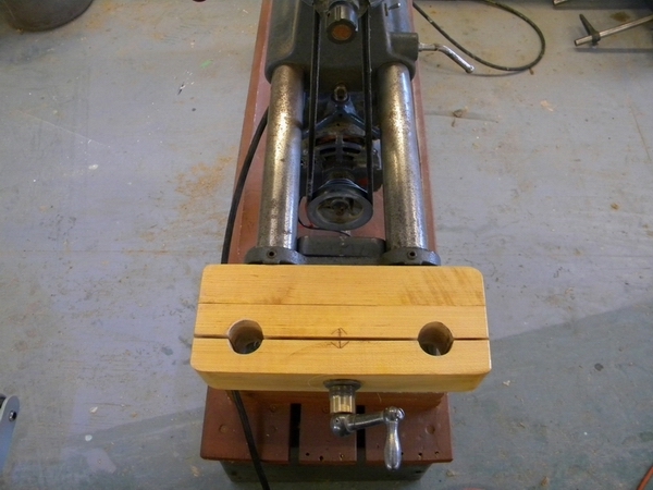

This one shows the drive setup a little better. I do have a speed changer. It's just not shown in this photo.
[ATTACH]19611[/ATTACH]
