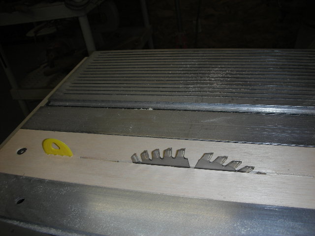

OK, I'll confess -- I rarely use the upper saw guard; but I do use a splitter. I used to make my own, but now I just use an MJ splitter like Dusty.
Please don't think I'm recommending you follow my bad habits and stop using your upper guard, but there are times when it's in the way. That's a good time to use a splitter.
For those not familiar, here is a picture. That little piece of plastic is all you really need to keep the wood from squeezing back together behind the blade and causing a kick back. It also helps keep the cut straight.
[ATTACH]1155[/ATTACH]
