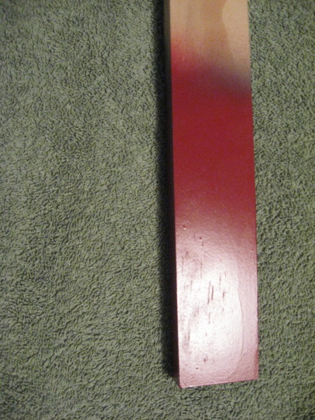

The wife had to have this cabinet made out of pine
She is going to paint it. Found a spray can at Menards
which is called satin.
Sprayed some with primer first on a piece of scrap.
Has to much sheen to it and does not cover very well.

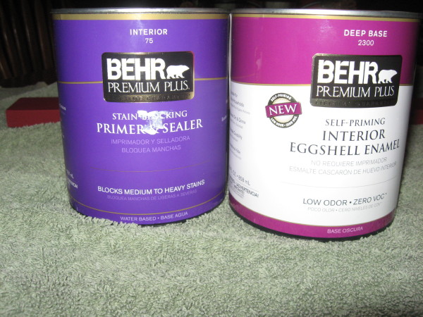

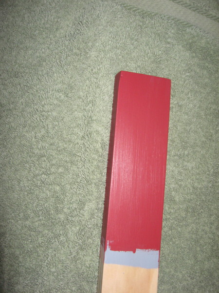

[ATTACH]20618[/ATTACH]I gave up on the milk paint idea. I think it is $20.00 a quart at Rockler.
Went to local HD . They i a paint lady that everyone says
is sharp on paint stuff.
Had a sample of curtain along for color match. She ask what i was painting
on and if it was gloss, flat, etc. Told her i wanted flat. She said that would be
quite hard to clean dust off. They had flat,satin, semi-gloss and gloss.
She mixed up the satin and that is what you see in the pictures.. She said on pine I should use a tinted primer to cover well. $23.00 for primer and the paint.. It is call arcrylic latex... Easy to apply as it is like whipped cream.The picture with the shine is the spray paint from menards. did not cover well.......
