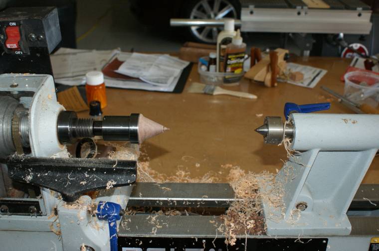

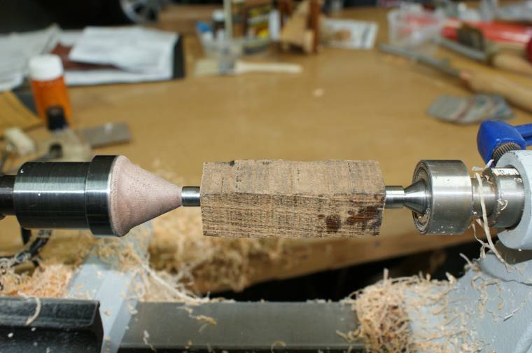

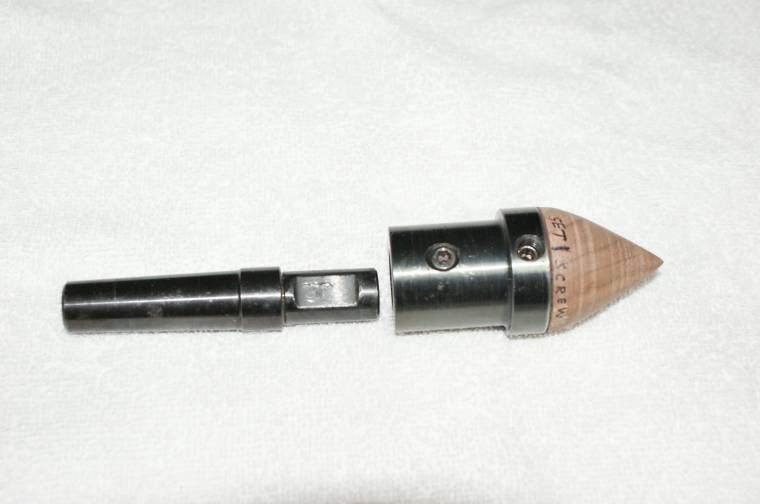

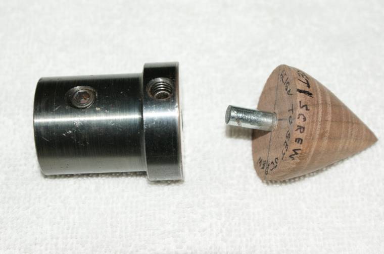

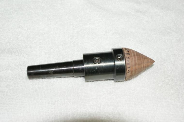

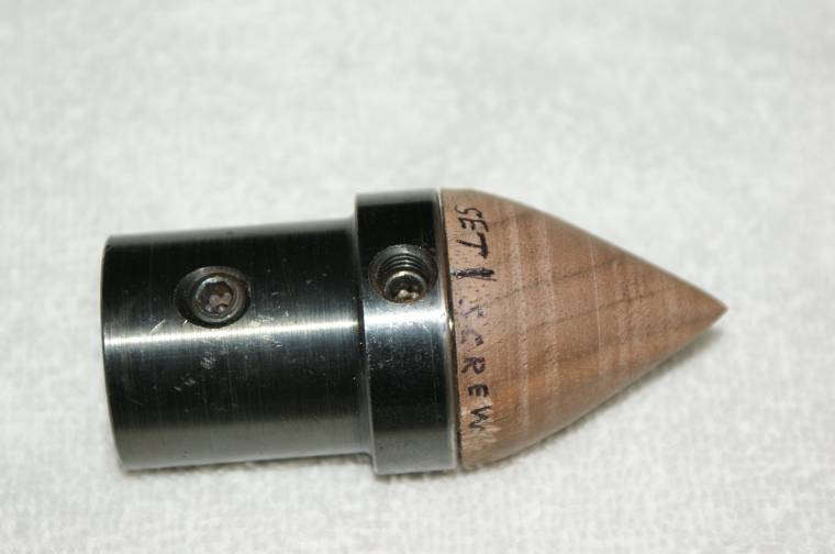

I think that you can do what you want with the SS screw chuck
[ATTACH]20917[/ATTACH]
[ATTACH]20918[/ATTACH]
[ATTACH]20919[/ATTACH]
[ATTACH]20920[/ATTACH]
[ATTACH]20921[/ATTACH]
I think that I posted about a year ago. Hope it will work for you.
Bill V

- dead drive center.jpg (75.68 KiB) Viewed 5073 times
- dead drive center on the screw chuck.jpg (80.49 KiB) Viewed 5074 times
- drive center and #2 taper assembled.jpg (84.32 KiB) Viewed 5062 times
- drive center and drill chuck #2 taper.jpg (79.98 KiB) Viewed 5066 times
- drive center separated.jpg (83.59 KiB) Viewed 5061 times

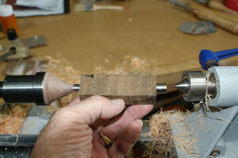

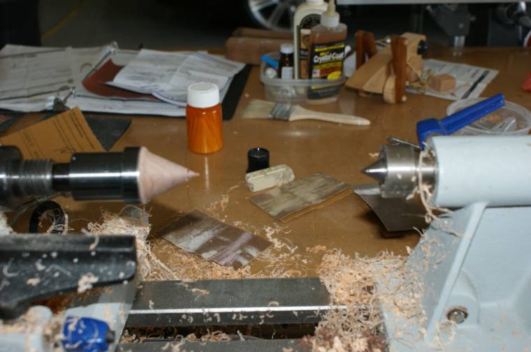

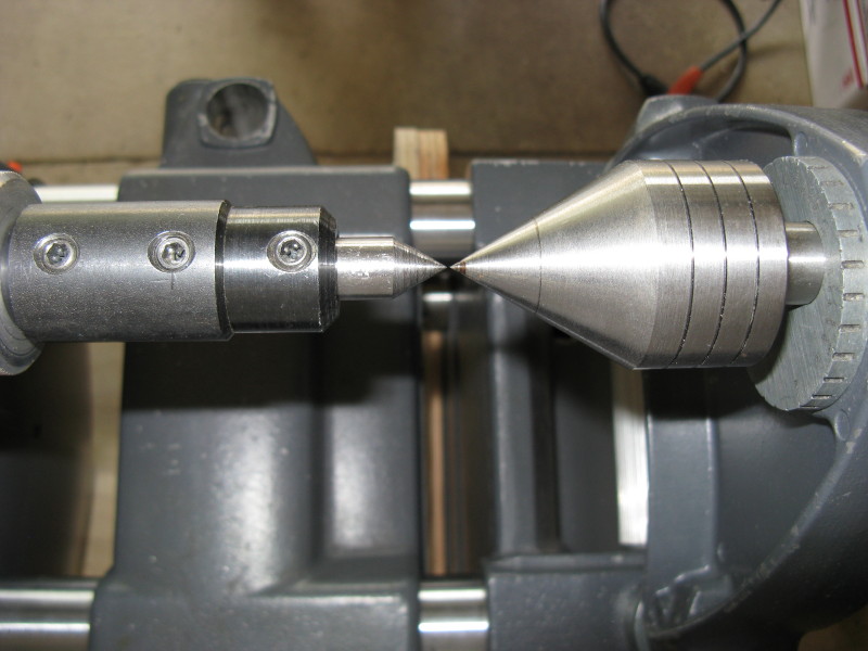

Here are a few additional pics that show the chuck mounted on a mini lathe.
[ATTACH]20922[/ATTACH]
[ATTACH]20923[/ATTACH]
[ATTACH]20924[/ATTACH]
[ATTACH]20925[/ATTACH]
Hope they help
Bill V

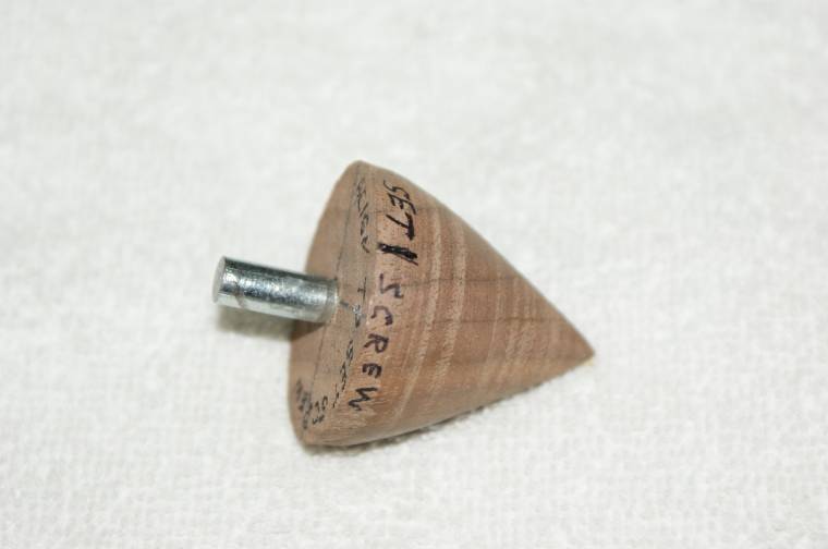

I only turn between centers if it's a one barrel pen such as a long clicker, bolt action, or an artist sketch pencil. I made a cone drive very similar to wa2crk out of oak except I dedicated my ShopSmith screw drive to it so I didn't index it like he did for repeatability when putting it back on.
The burnished oak is pretty durable and I have only had to resurface it once, but that was because my gouge wasn't sharp and I over tightened things so the blank wouldn't slip on the cone drive. As long as I keep my tools sharp and don't over tighten, then it works great. I also camfer the inside edge the brass tube with an X-Acto knife to remove burrs and ease insertion of the pen components.
I tried the steel router centering bit held in a ShopSmith router chuck and found it had more runout than my oak cone drive.

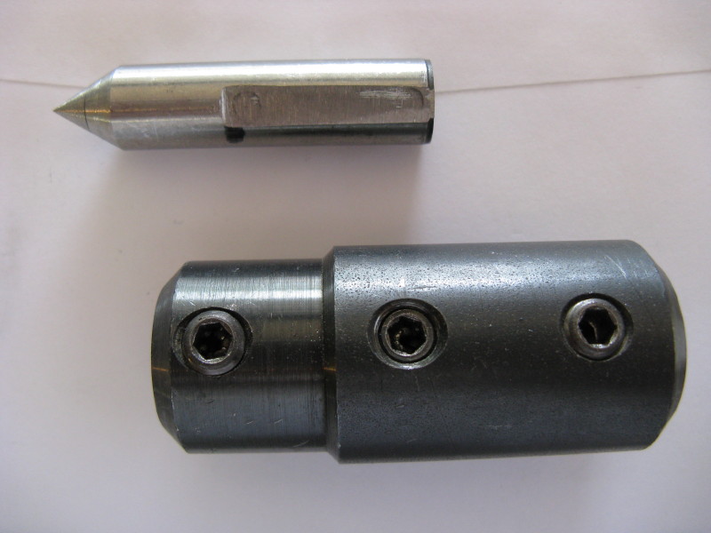

I made a drive center from a shoulder bolt to get a good 1/2" diameter to put in my SS router chuck. Did the rough grind with a bench grinder and finished the angle with a file while it was mounted in the router chuck.
If you want to buy a drive "dead" center ready made here is a source: http://www.penturners.org/forum/f172/custom-made-penturning-tools-accessories-92501/
Look at the bottom of the page. He has basically what I made for myself, only he has hardened his. Note I have no connection to him, only offering a possible source.

- Dead center 2.JPG (83.89 KiB) Viewed 4996 times
- Dead center1.JPG (98.12 KiB) Viewed 5012 times
