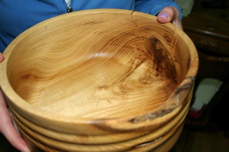

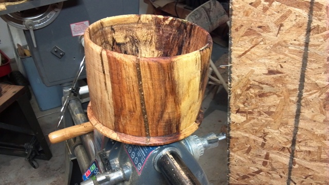

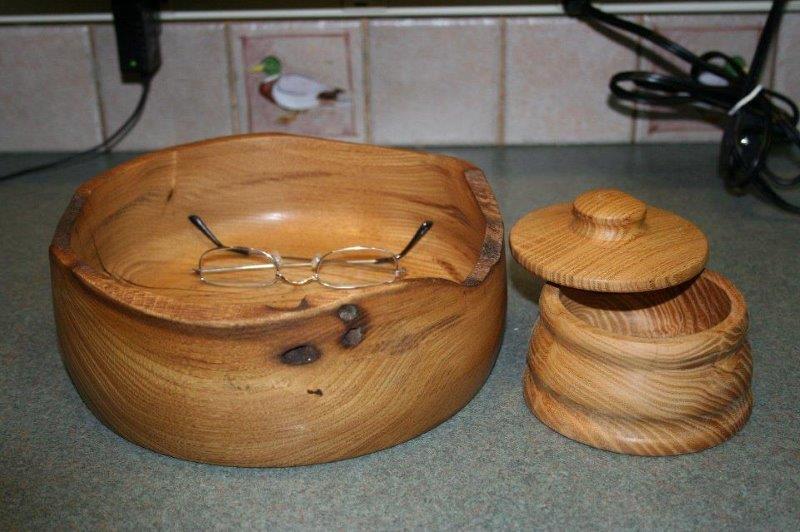

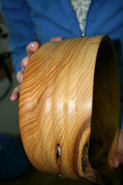

A friend gave me some old locust, that was very dry and very hard. He had tried to use in his wood stove, but couldn't split it. I took the chain saw to it, and bandsaw, then turned it. I gave up when i noticed a number of splits, then a month or so later talked to a friend of mine who did a lot of turning 45 years ago in high school. He suggested taking two part epoxy, thin with acetone or lacquer thinner, add oil paint pigment to color, then inject via a syringe. Turned a little afterword to remove excess then sanded. Finished one with linseed, other with butcher block oil. Worked like a champ!![ATTACH]20976[/ATTACH]

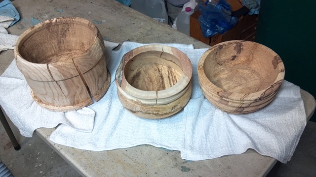

Swampgator, the short answer is YES.swampgator wrote:Is it possible to mix some of the sanding dust with the CA glue or woodglue to make a filler and patch? I know this works for other cracks in other wood projects, but I don't know if it would be stable or durable while turning. Thanks.
Here is a before and after picture of the bowl on the left that had several large cracks. I mixed up some fiberglass resin with some sawdust and two hours later I was able to turn the bowl down to it final size.

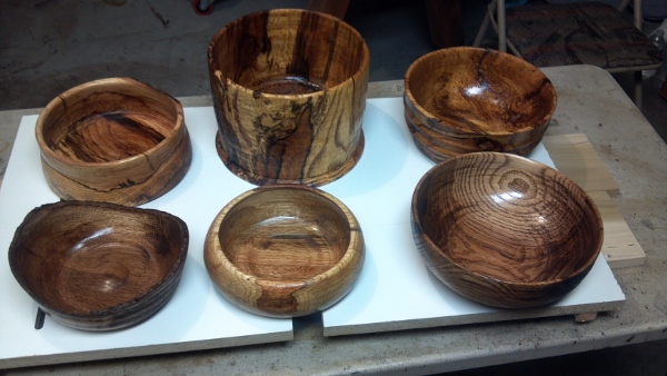

Here are the first 6 bowls that I turned green and bagged for later finishing.
I have learned a few things such as not turning to the final thickness until the bowl dries may not be a good way to go. In all cases the bowls were out of round after drying for 2 to 3 months. Made it much harder to finish turning. My next efforts will be to turn the green wood all the way to the final thickness,bag them and let them warp/split/crack or whatever they want to do and let it go at that. I will sand them and cut off the tenon after they dry.
[ATTACH]21254[/ATTACH]
All these came from the same log. The front left one has a natural bark edge. I figure if I sold them for about $300 each I might break even on my labor costs
