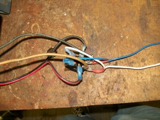

Bill, Reading your response here caused me to dig out the old Crafter's Station Motor. It was declared dead on arrival when I acquired the Crafter's Station. I now wonder about that prognosis.
Using a Fluke 189 the resistance from the yellow wire to the blue wire (run winding I think) is .27 ohms. The start winding (red wire to black wire) measures 5.26 ohms. There are no shorts from any of the four wires to the case.
Is there a chance that this motor has been improperly diagnosed.
Yes, the readings sound good so I would believe the motor is good. I have been able to reuse anymotor that the had no short to ground for the input power wires. Two wires for the run windings and two wires for the start circuit for the motor. Of course, I would do a smoke test later to see what happens.dusty wrote:Bill, Reading your response here caused me to dig out the old Crafter's Station Motor. It was declared dead on arrival when I acquired the Crafter's Station. I now wonder about that prognosis.

I agree the resistance measurements appear normal. Addition of heat may alter that.
Who made that diagnosis? If it was you, do you remember any details that led you to that?

It is a long story. I received a PM from a member who was having problems with his Crafter's Station. I tried to help but he had no electrical background and was fearful of working with the wiring. He had been told by a "motor repairman" that the motor needed to be rewound. It is discolored and some of the wax cord is broken and pulled away. With that report, he gave up and offered me the Crafter's Station.
Now you have the rest of the story.
