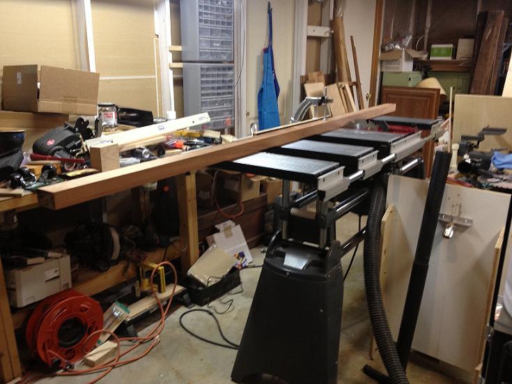

After getting the first edge jointed it was time to rip that 1/2" off so I could finish with the dimensioning. Just in time for the project :rolleyes: , I had ordered the Kreg Band Saw Fence while it was on sale. It arrived in a couple of days. By the way, when you order the Shopsmith version of the Kreg band saw fence you get a "free" :rolleyes: 20" aluminum miter extension because the band saw fence extrusion that comes with Shopsmith version of the Kreg fence is the exact same as the Shopsmith 20" aluminum miter extension p/n 556005. The Shopsmith portion of the manual makes this point. The fence easily installed and was adjusted for the drift of my 5/8" band saw blade. Probably took 30 minutes, tops. Using the newly installed Kreg, I easily riped that half inch off the board. The cut off the blade was excellent and it went like butter through the 8/4" Spanish Cedar. Unfortunately I forgot to document this part of the project. :( But I used the same set up as in the photos below.
I am really impressed with the Kreg fence, the 5/8" blade and, of course, the Mark V itself. I should say that up until this project, I had mostly used the table saw for ripping and thought the band saw's main function was to cut curves. I may have to rethink that.
After getting the board down to a width that could be managed on my jointer, I face jointed it and then thicknessed it. Again no photos, but I can report that my planer stand, which some thought would be too flimsy, easily handled the load.

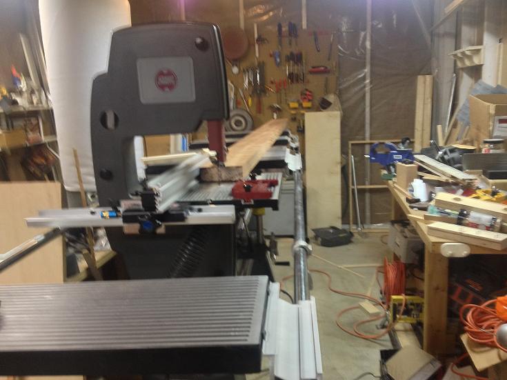

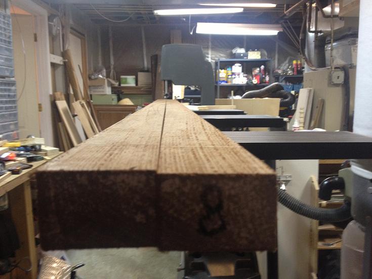

Then back to the Mark V to rip it in half (this will allow me to get one stile and two rails out of the board) on the band saw. Here's a couple of after photos of that cut showing the Shopsmith set up. Using both floating tables, the main table and the extension table I had plenty of infeed and outfeed support. Same set up I used to make the first rip (but I forgot to take photos). I can't imagine how I could have done this on any other band saw without a lot of temporary supports and/or helpers. I am really impressed with the accuracy and quality of the cut I got straight off the blade using the Kreg fence.
Sorry for the lousy photos.

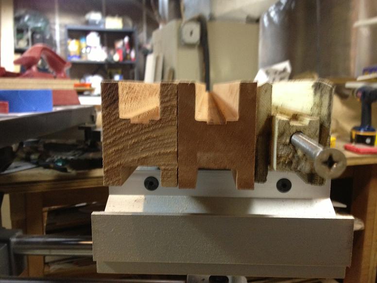

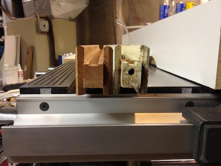

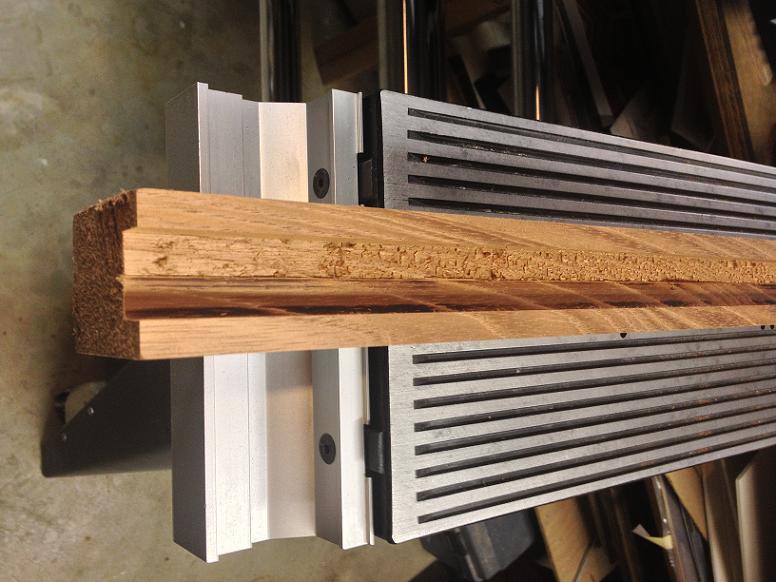

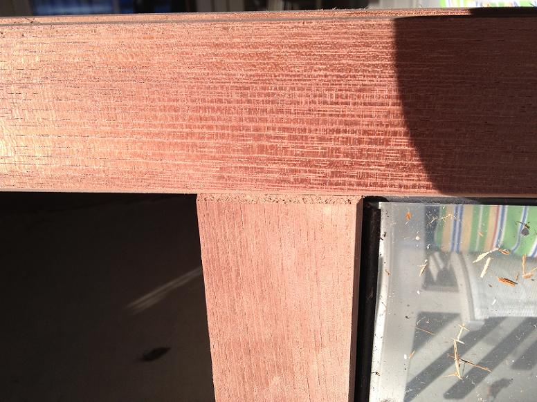

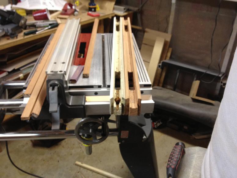

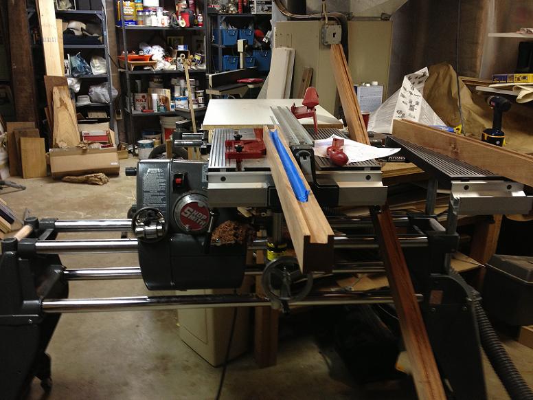

After milling the pieces to dimension, the next step was to add some grooves. The original has a bottom groove .910 wide by .450 deep. The top groove is .910 by .750 deep and then has another, narrower groove cut in the center of the top groove. Refer to the bottom photo in this post to see what I'm talking about.
To ensure the groove would be centered in the stock, I decided to cut the groove's width in two passes. This meant setting up the dado blade for half the finished width, running the stock through, rotating the stock 180 degrees and running it through again. I think this ended up being more trouble than it was worth. The Spanish Cedar is so directionally sensitive that one half of the groove would be smooth and the other half with lots of tear out, as seen here:
[ATTACH]22747[/ATTACH]
The end result was I had to do a lot of hand sanding!

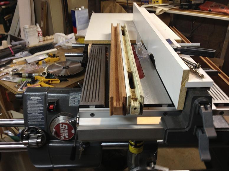

Here's a couple of shots of the set up. The bottom groove has already been milled in these photos and the rails/stile have been flipped to cut the top groove. The blue tape is there to remind me not to further mill the bottom groove as I work on the top grooves. Since they are the same width it would be very easy to lose track of which way is up!
[ATTACH]22748[/ATTACH]
[ATTACH]22749[/ATTACH]

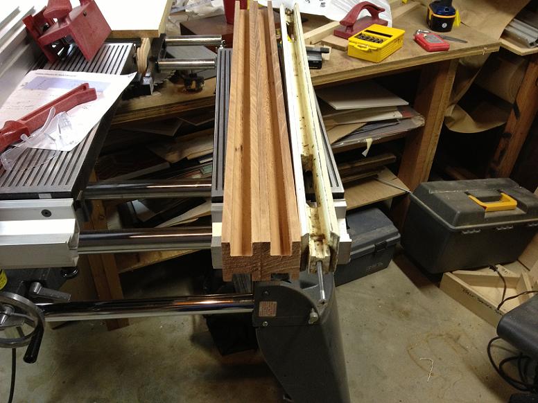

Here's a side by side showing the old rail and the new rails milled with their top and bottom grooves after sanding to reduce the tear out.
[ATTACH]22750[/ATTACH]

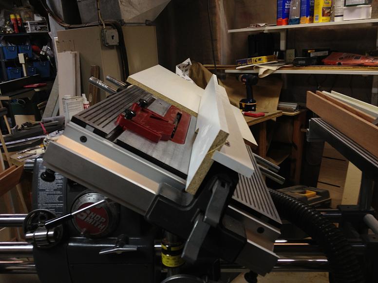

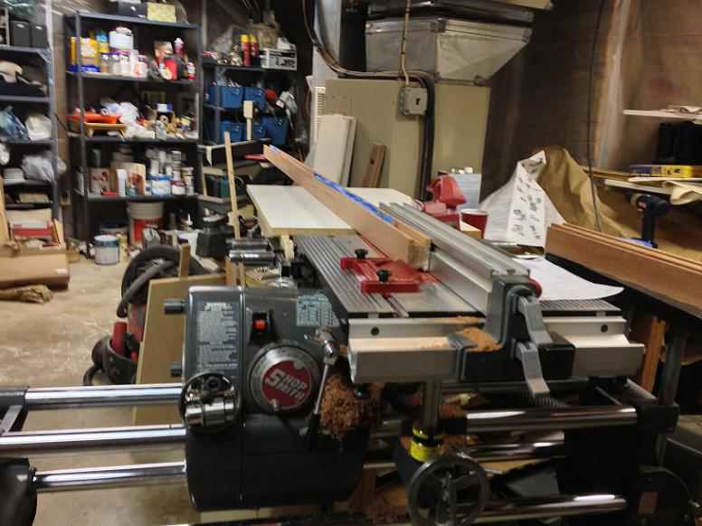

The original rails and stile have a beveled edge detail. This was the set up for the bevel, showing the outfeed table and the rip fence extension I use (it also doubles as the fence I used when burying a dado blade, hence the cut out). The fence extension attached with a couple of sliding T-nuts to the top of the fence.
[ATTACH]22762[/ATTACH]

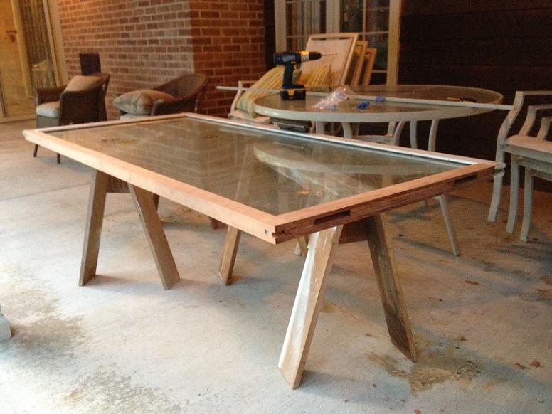

I got pretty anxious so I decided to do a test fit. Also intended to measure the length to cut the stile. I was pleased that everything fit and that everything looks like it will work.
[ATTACH]22765[/ATTACH]

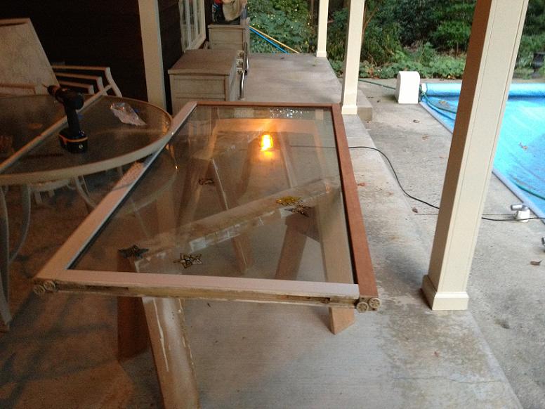

More progress today. Cut the mortises in the rail for the wheel assemblies. Used a Forstner bit to hog out most of the material and cleaned up with a chisel. Not shown in this photo are the two smaller mortises I had to cut to accet the large square nuts that accept the 1/4-20 x 3.5" flat head machine screws that hold the frame together. I cut those mortises but no photos. I learned I am a lousy at cleaning up a mortise with a chisel. Luckily, this will not be seen when the door is put together.

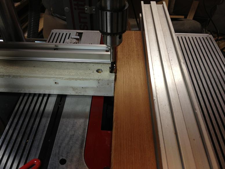

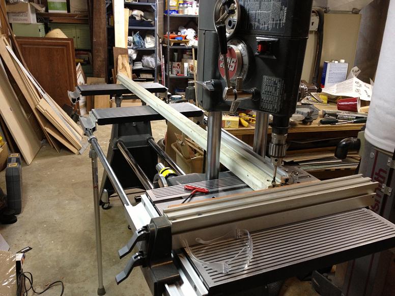

A few last details for the stiles. The stiles have a countersunk hole for the machine screws. In addition, there's a half round relief cut at the end. Rather than measuring the position of these, I used the the old stile to line up the Forstner bit (and the 1/4 inch twist bit for the machine screw) and then locked in the position with the miter gauge and rip fence (the stop block is to get get clearance).
[ATTACH]22812[/ATTACH]
Here's a photo showing the support tables for this set up. For some reason I didn't take photos after I replaced this rotten stile with the one I am building. Oh well.

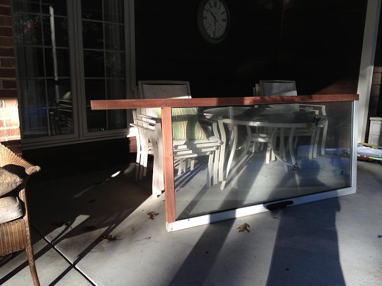

algale
Posts: 4841

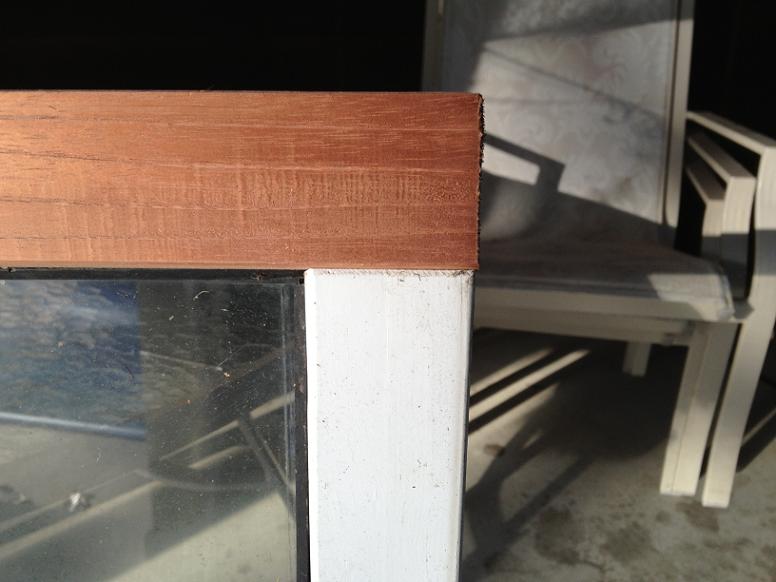

Done!
Post by algale »

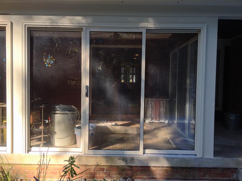

Well, it is in and it fits, slides, locks and does everything it is supposed to do. SWMBO is thrilled. The cost to replace this unit would have been over $3,000. I think my tool budget has been justified!
[ATTACH]22911[/ATTACH]
