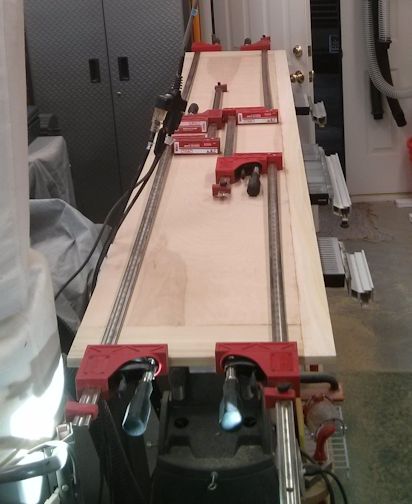

This holiday season my daughter has requested a window seat to replace a seat removed by a prior owner. She plans to paint the seat and made her desires very specific. The front section has been completed in a single panel 106" long. While assembling I encountered one of those hey wait a minute moments as my longest clamp is 51 inches long. Thus as noted in the picture I used a total of six clamps. Three each for top and bottom clamp rows. Jim

Thats using your head for something other than a hat rack. :D :D Pretty clever, thanks for posting.

JPG40504 wrote:Much can be said for pipe clamps in similar situations.:D
I agree, in fact I reached for the pipe clamps first. When I was having fits attempting to extend the clamp length I looked at the clamp rack and decided the red ones would do the same job without requiring reconfiguring and then having to return them to original length. For me being a lazy sort it was a no brainer. Jim

Looks like your clamps need to be in a different position. Clamps set across the work at the stiles and rails connection.

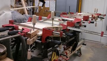

I knew some sharp eyed woodyworker would pick up on that point thus I must now bore you with the second more complicated picture. Yes I did clamp both directions. The first picture was intended only for purpose of illustrating use of multiple clamps to span a long area. Then again I had intended that to be the purpose of the thread:D Jim
