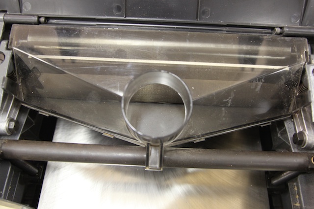

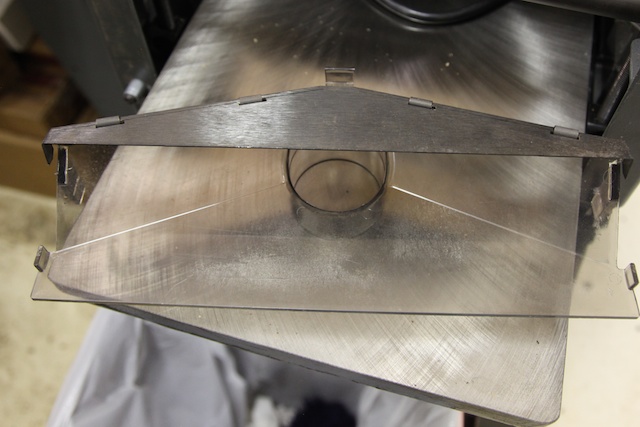

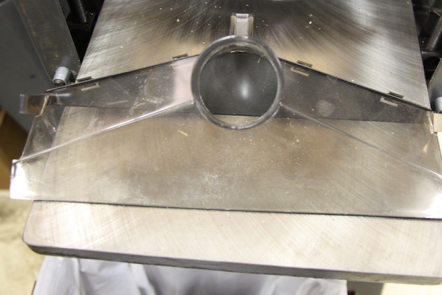

Pictures now -
[ATTACH]23674[/ATTACH]
[ATTACH]23675[/ATTACH]
[ATTACH]23676[/ATTACH]
You can see in the last pic how the chips are mostly blocked from traveling down to the table.
- Shopsmith Planer Chute 6.jpg (84.24 KiB) Viewed 5096 times
- Shopsmith Planer Chute 5.jpg (82.56 KiB) Viewed 5096 times
- Shopsmith Planer Chute 4.jpg (91.01 KiB) Viewed 5096 times

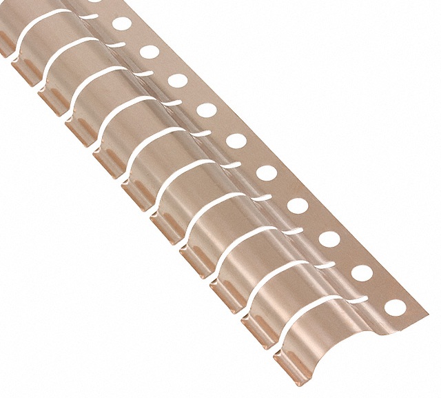

How about an EMI/RFI fingerstock gasket?WmZiggy wrote: Anyone got any ideas out there where to find a 12" potential collector brush?
[ATTACH]23682[/ATTACH]
Check out this link for a variety of styles. Most are about 16" long, and prices are in the $15-$25 range.
- 0097043802.jpg (83.68 KiB) Viewed 5052 times
'Old' metallic Christmas tree garland. Color optional!
Orrrr, hang a bunch of cheap necklace chains.
Orrrr hang a bunch of 'eye' bolts.(spacers optional)
Orr move to the tropics.

Thanks for the pictures Mike! That really helps me visualize how the add-on part works. I will order one.

Well, if you followed this thread and made comments you know I had static electricity causing shavings to stick to my planed boards. I posted some pictures of it. One of you wrote in that I needed to add the planer dust chute bottom (SS part # 517920) to my planer dust chute. So I ordered it from SS and it came the other day. I planed some wood and what a difference it made - 99% pick-up. I did run my static collection wire to the chute bottom and I think that helped too.
I just wanted to thank you all.
