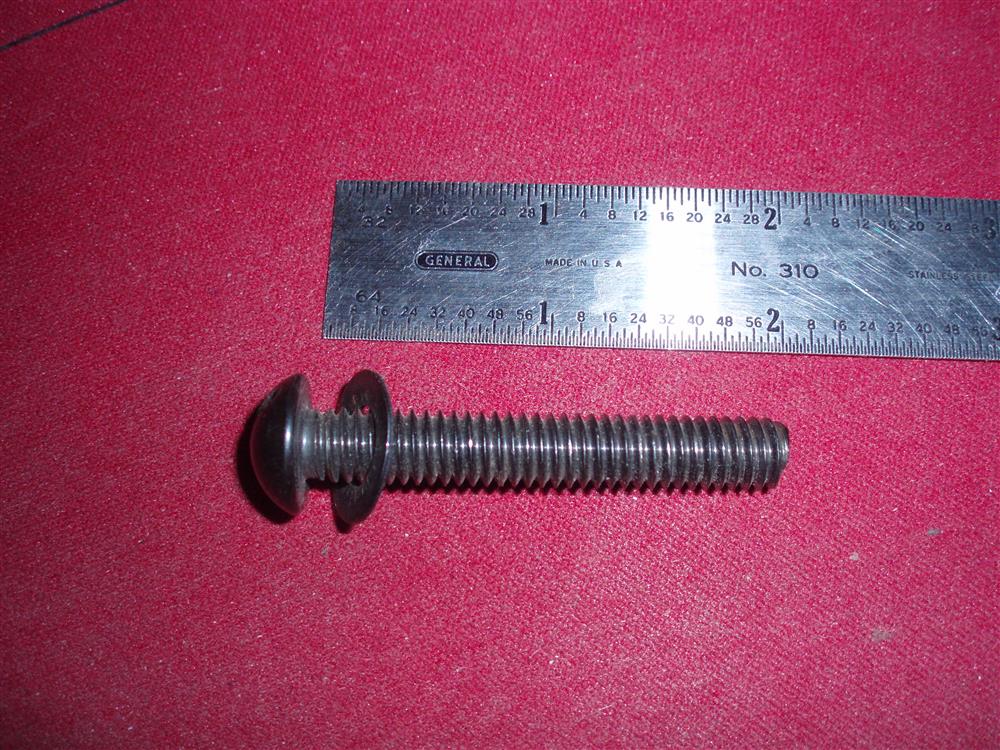

JPG40504 wrote:Nothing has changed but I have a question. The Kit contains a 1/4"-20X2" Round Head Set Screw. Where is that used?? Idler eccentric clamp?
Nope! Not the Eccentric Clamp Screw. That screw is 1/4"-20x1 3/4" but it is a Cap Screw not a round head.
I do have a 1/4"-20x2" Round Head in the spare parts drawer along with the other parts from my Shopsmith Help Kit. Problem is that other hardware has been added to those drawers and I can not differentiate.
[ATTACH]25508[/ATTACH]

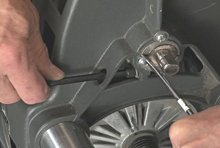

1/4"-20x1 3/4" Hex Head Cap Screw in Eccentric Bushing
I don't know why I am trying to get all of this stuff sorted and organized after all these years of general chaos???
Machine Screw 002.JPG (186.17 KiB) Viewed 765 times

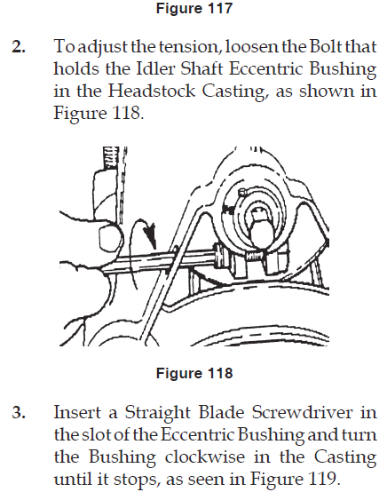

The Eccentric Bushing-Belt Tensioning
I did run across this in the Maintenance Manual. I don't recall having read this before. It is interesting though in that it clearing shows the Hex Head Bolt while instructing the use of a slotted screw driver.
[ATTACH]25510[/ATTACH]
Capture Eccentric Bushing_Belt Tensioning.PNG (45.99 KiB) Viewed 675 times
