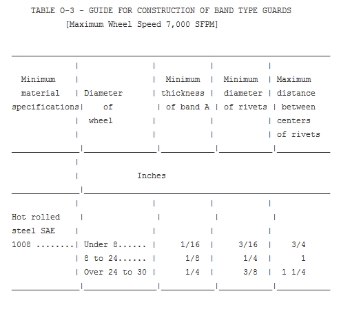

A very quick look at OSHA regs seems to suggest hot rolled steel 1/16 in* minimum for the outer edge of the guard, and that is assuming I stumbled on the right section (hard to say since it is not displaying right on my phone).
Looks like I should rethink my approach from the beginning.
*edited from 1/8, typo.

[ATTACH]25546[/ATTACH]
This it????????????

Looks like what I saw, though as indicated I wouldn't count on my search results until I checked them on a computer with a proper screen the table wasn't formatting right and the page text hard enough for my eyes that I am not sure I found the right page.
HF had 8" for about 50, but I think I'd be better off returning the when for a 6 inch since the sfm will be less and I can mount it on more and cheaper things. I still hope to use the Shopsmith because I would like the lower speeds.
