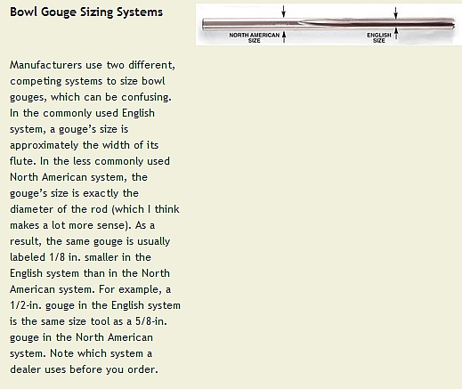

You may be measuring the wrong part.]25610[/ATTACH]
http://www.americanwoodworker.com/blogs/tools/archive/2009/10/22/bowl-gouges.aspx
bowl gouge sizing.jpg (100.63 KiB) Viewed 2863 times

I think that in Europe, gouges are sized by the width of the flute, not the diameter of the stock.

From the woodturners catalog ([url]http://www.woodturnerscatalog.com):[/url]
Spindle gouges-are measured by the diameter of the round stock.
Bowl gouges-are measured by the width of the flute. Add 1/8" to the flute size and you will have the diameter of the round stock. Note that there are a couple of brands that are exceptions.

Ok guys. Today has been a good day. I learned something new. I never knew that there were two different standards. My SS gouges are made to the Euro standard. I guess I will have to move the lathe to the left side of the garage.:D
