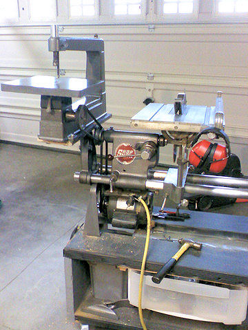

Here is something similar on an older Shopsmith..........for ideas:
[ATTACH]25876[/ATTACH]
hybrid 3.jpg (65.31 KiB) Viewed 1622 times

Take the blade insert off and put a pulley where the blade is. Use the table for a stand and put the belt on. It may be a little high but should work just make sure the blade is running the correct direction.
