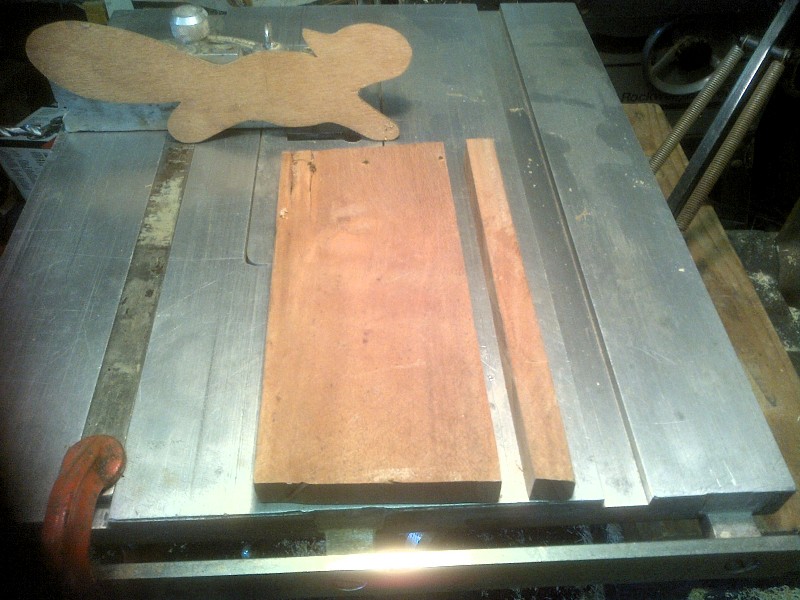

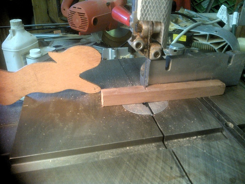

Cutting the blanks to length, (SS bandsaw)
[ATTACH]25850[/ATTACH]

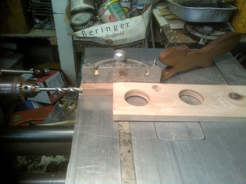

Drilling the blanks, (10 ER)
[ATTACH]25851[/ATTACH]

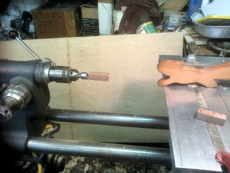

[ATTACH]25854[/ATTACH]

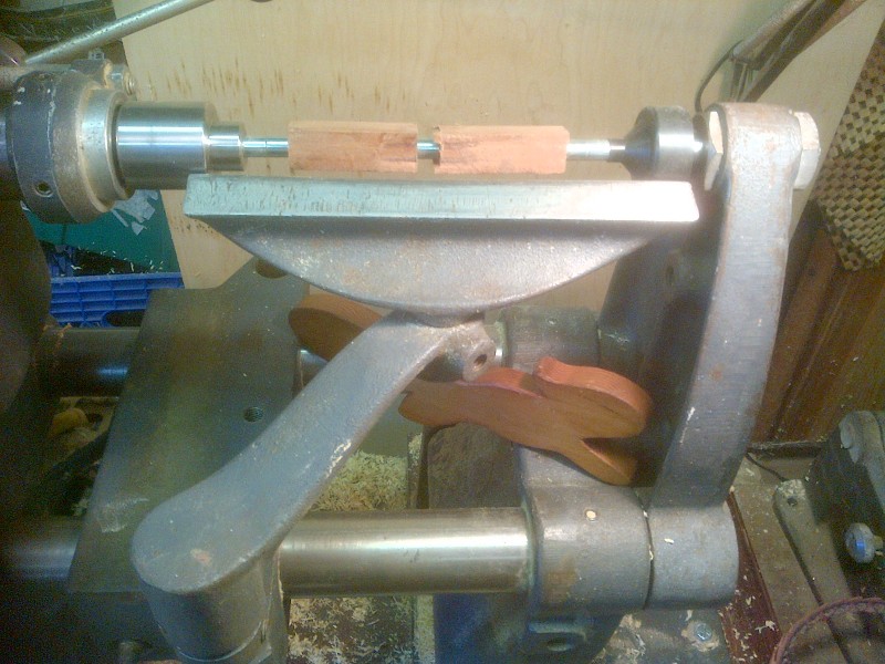

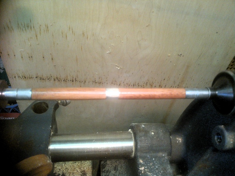

Blanks on mandrel with mandrel saver.
[ATTACH]25852[/ATTACH]

- blanks cut to length.jpg (142.39 KiB) Viewed 9053 times
- blanks drilled.jpg (117.9 KiB) Viewed 9056 times
- blanks on mandrel.jpg (124.79 KiB) Viewed 9054 times
- blanks trimmed.jpg (132.71 KiB) Viewed 9055 times

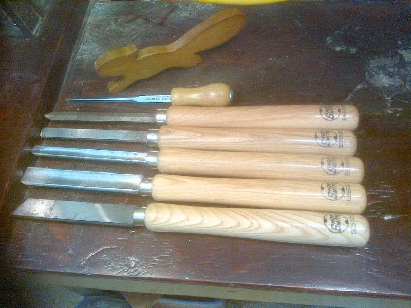

This is my set of ShopSmith chisels and a tube insertion tool I made from a Craftsman punch and a recycled handle. I used the skew to turn the pen.

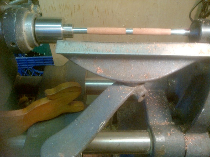

Here the blanks have been turned and sanded.

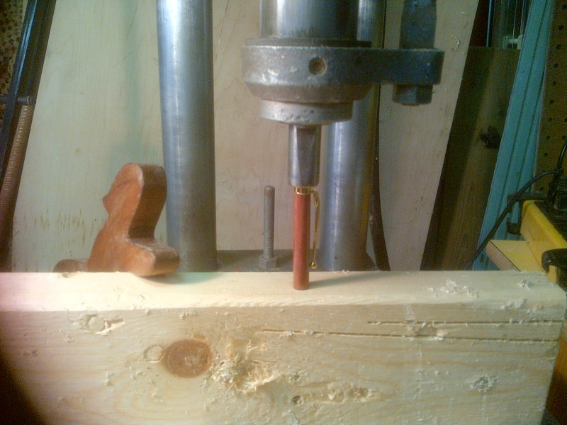

Assembled using my 10ER dedicated drill press.
[ATTACH]25858[/ATTACH]

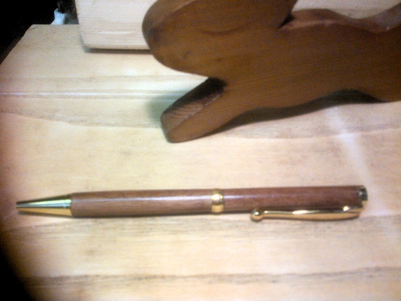

And here is the finished pen.

Nice job. I like your assistant.

fredsheldon wrote:Nice job. I like your assistant.
I included the ]popular demand[/URL], by Ed (reible).

Nicely done..
Very nice both the pen and presentation. Glad to see how it can be done !

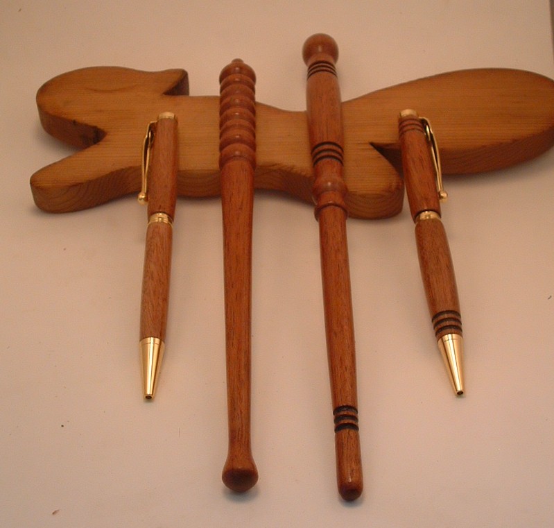

I spent some quality time in the shop this weekend.
[ATTACH]25901[/ATTACH]
Left to right: pen #2, wand for my granddaughter(age four), wand and pen set for my son outlaw's birthday present.
