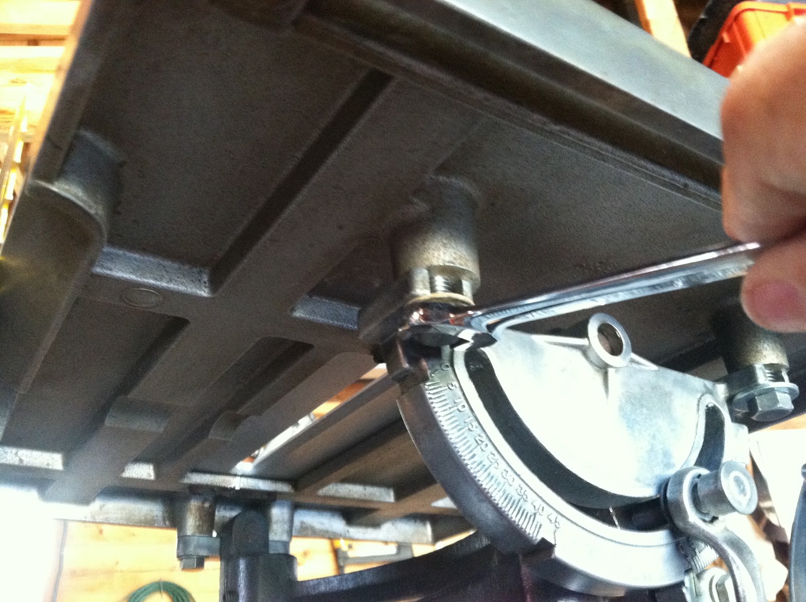

JPG40504 wrote:If the 4 mounting bosses on the table bottom are 'coplaner' to each other and parallel to the top surface of the table, and the trunions mating surfaces are 'coplaner' when attached to the tie bar, then the table and trunion mounting surfaces all will be 'coplaner' when secured with the screws. This does not create a change in the 'flatness of the table regardless of how much torque is used to tighten the mounting screws.
If however the table mounting bosses or the trunion mating surfaces are not 'coplaner', the table may be pulled out of flat when those surfaces are 'forced' to coincide by tightening the mounting screws. I think the table is the most likely part to deform.
It is difficult to determine this 'coplanerarity' due to the spacing and shape of the trunions etc.. However if the trunions with tiebar etc. are set upon the table mating surface(no screws) one could just look for any gaps. The presence of any gaps indicate where shimming is likely needed. However one must determine if more than one shim is needed to also maintain table top to pivot axis consistency between both pivots. Not doing so will likely create that heeling discussed over on the other thread. I do not know of an easy method to determine that consistency other than trial and error/correction.
I have reason to believe that they may not be perfectly coplanar. The infeed/rear boss may be a tiny, tiny bit short (or the outfeed/front a tiny, tiny bit tall).
Or my test tool (1" MDF) is not flat.
The test tool in question is a piece of 1" MDF that has been cut to span the trunnion bolt bosses on the bottom of the table. This "test tool" rocks ever so slightly on one of the diagonals. A .003" shim transfers the rocking motion to the other diagonal while reducing the movement to nearly nothing. The ideal shim would be .0025" but I don't have one and (after all) this is a wood workers table saw. What's a .0005" deviation going to cause.

beatnik wrote:Doesn't really matter how stout a chunk they are, the mounting surfaces can still be off. A piece of mdf isn't going to tell you much at those tolerances.
I don't really disagree but for right now I can do no better. Does it matter at all that when placed on a piece of safety glass there are no gaps equal to or greater than .001". That's how I chose this "test tool".
Could you use four known accurate spacers and set the removed trunnion/pivot set up from the table upside down on them on your glass ? Do the same with your table setting the mating surfaces on those spacers ? Have you checked everything is parallel ?

Yes, that is what I am dealing with except that I have a 510 table. If I could test that all reference surfaces were parallel (coplanar), I would have this snockered. The main table not being perpendicular to a drill bit (axis of rotation) was the starting point.beatnik wrote:Could you use four known accurate spacers and set the removed trunnion/pivot set up from the table upside down on them on your glass ? Do the same with your table setting the mating surfaces on those spacers ? Have you checked everything is parallel ?

I am going nowhere fast. The other table (from the Shorty) has been checked and today's readings are also different than yesterdays. This table checks near perfect (on the diagonals) except for what would be the right hand corners (front and rear) in the saw mode and they are only .006" to .010" off. Everywhere else, on the diagonals, the readings are less than .005".
All I can conclude is that there is a variable involved that I definitely do not understand.
