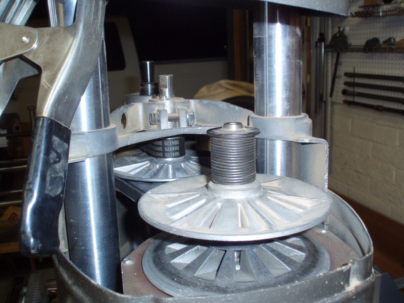

[ATTACH]25942[/ATTACH]
Sheaves shown at High Speed (belt pulled down deep in upper pulley where it is now stuck)

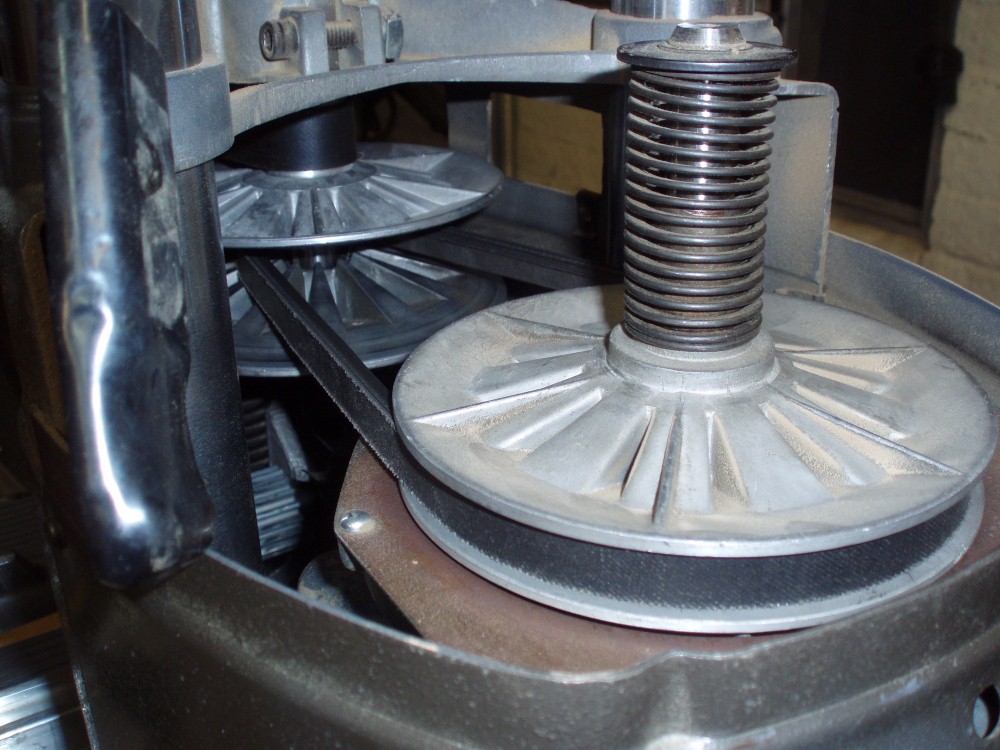

[ATTACH]25943[/ATTACH]
Sheaves shown at Low Speed
