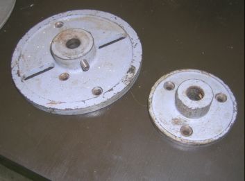

It just happens I purchased my 2nd Mk VII setup yesterday and it came with 2 plates... lg and sm
Not sure who makes them though - looks like they'll fit.
