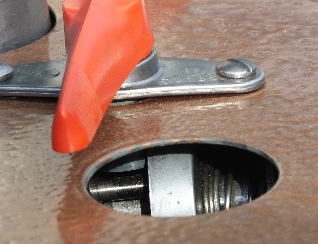

Here's what works for me: After you submit the post click on edit and then on "Advanced" and then the paperclip (looks like a paperclip) at the top. then you can cut (Ctrl C) the post and position it above or below the image.
There are probably easier ways but I haven't found one.
Click in the paper clip to 'attach'. As you apparently are doing.
Return to the 'Reply to Thread' screen and after positioning the cursor where you want the pix to appear, AGAIN click on the paper clip. A drop down menu will appear with a 'manage attachmennts' option, a list of your attachments, and an option to insert ALL attachments. The rest depends upon what you then click on.
You then end up with 'inserted pix'
[ATTACH]26378[/ATTACH]
[ATTACH]26379[/ATTACH]
The pix will not display in the reply screen but will in the preview and after being submitted.
belt cover hole aids assembly.jpg (554.19 KiB) Viewed 4238 times
pp parts.jpg (67.58 KiB) Viewed 4241 times

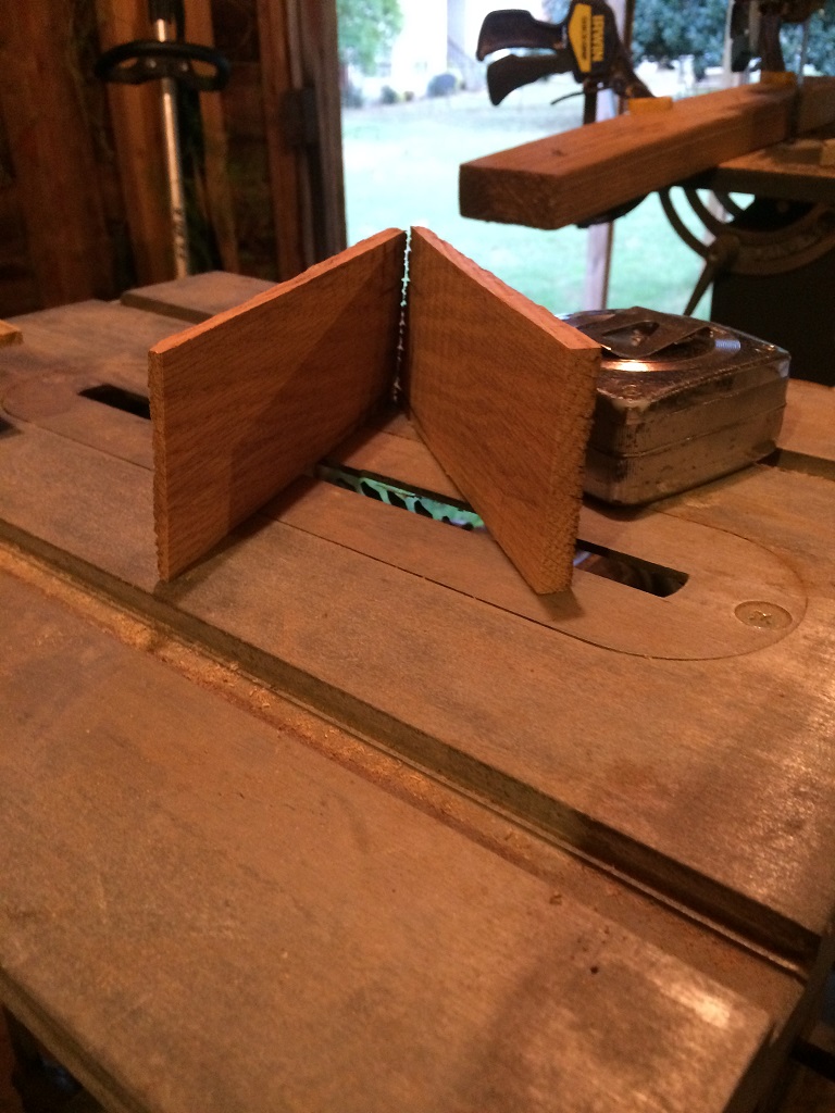

A small (2.5x6) piece of old barn wood
[ATTACH]26380[/ATTACH]

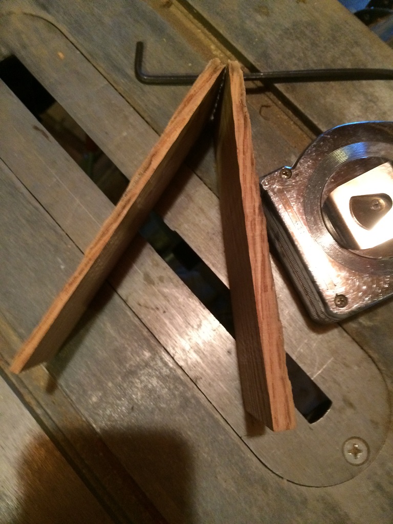

Same piece
[ATTACH]26381[/ATTACH]

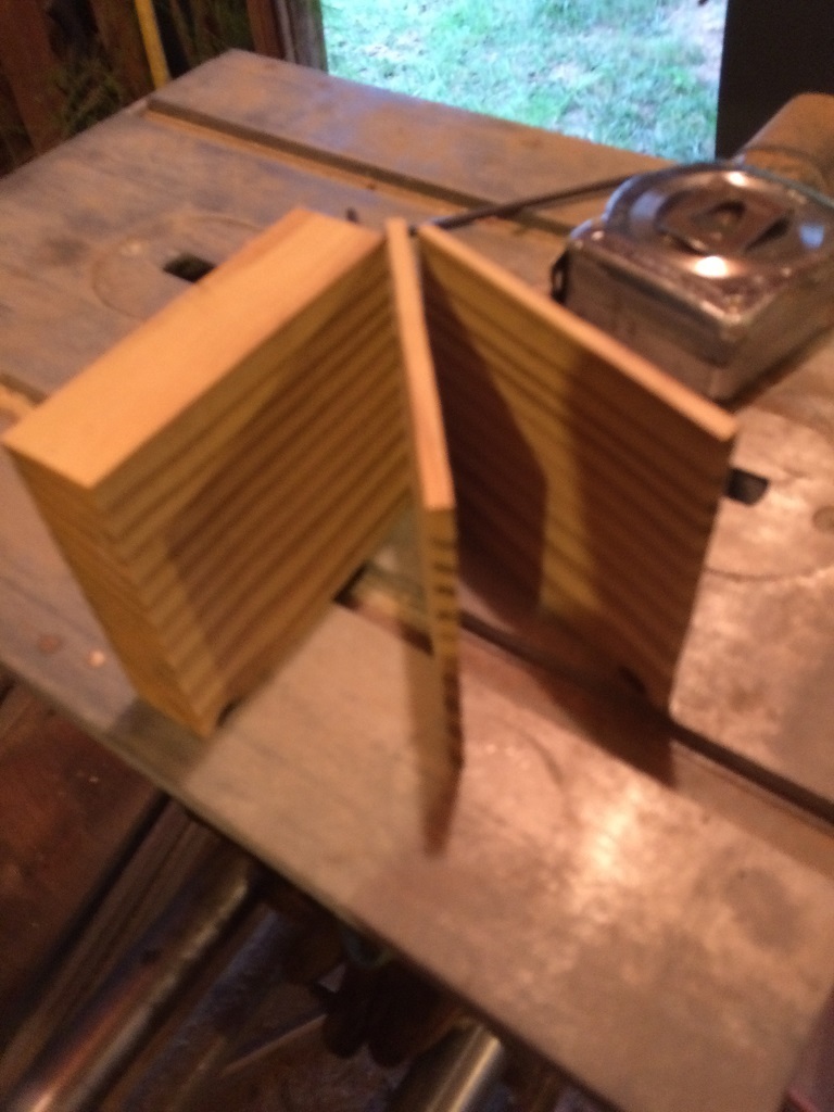

4x4 treated scrap piece
[ATTACH]26382[/ATTACH]
Resaw4x4 (1).JPG (179.75 KiB) Viewed 4226 times
