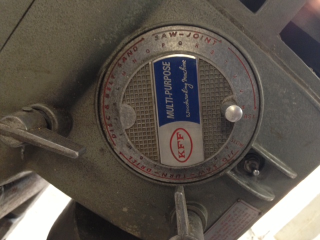

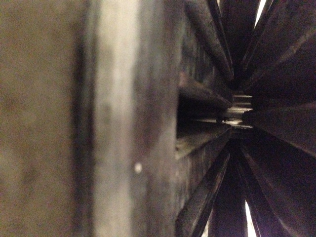

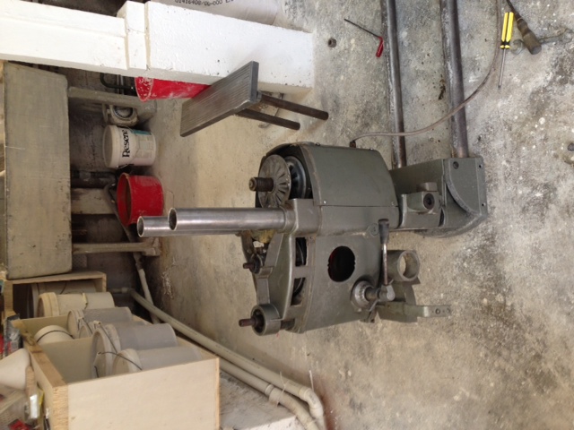

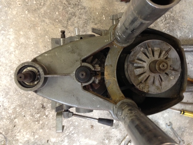

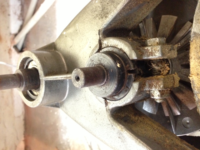

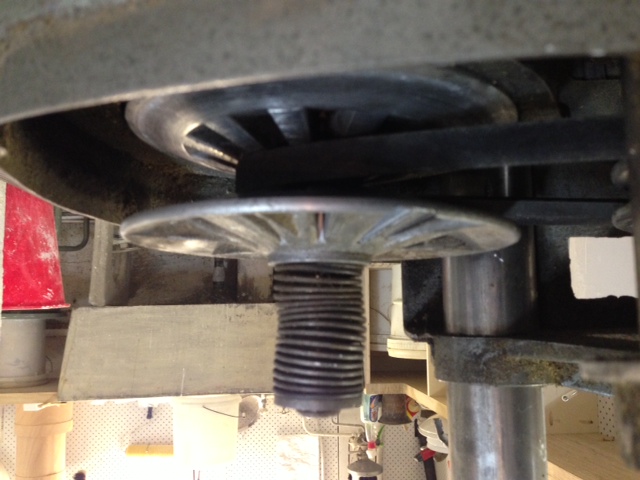

Pictures of clone in question
Seems identical as far as I can tell. Poly v belt is very tight and eccentric bushing is as loose as it can be with the slot for adjustment facing down in the centre.
The motor belt seems pretty slack when the variable speed is set at slow/stationary, and some motor belt vibration is visible when running at any speed (have removed the saw arbor/blade to isolate that as a contributor -problem persists.
Motor belt reads: B1 continental 13x630/A 25/A 660 EL
Poly v belt reads:Optibelt RB J362 D1

I take it all 4 pix were taken with the speed control knob at slow.
Some pix of the interior showing the mechanism that I assume moves what appears similar to the SS idler pulley would preclude incorrect assumptions on my part.
The most apparent strange situation is the floating sheave on the motor shaft. It appears nearly wide open. I am suspicious of the idler sheave being stuck open as well. That would explain the grossly slack motor belt.
Both movable sheaves may be stuck.
Interesting clone!
Second looks! The eccentric is proud of the casting. Assuming it was intended to be 'like' a SS, that would cause the idler sheave to possibly be too far away from the control sheave(clone variation may negate/cause that). I do not know what positions the idler sheave along the idler shaft. That motor belt would be too short on a M5. The motor may be positioned differently though.

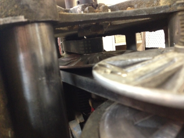

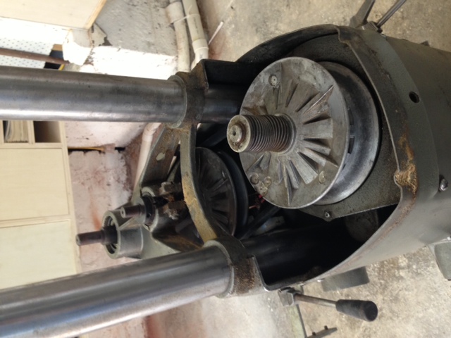

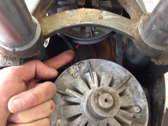

Yes all four were taken with the speed control knob at slow. Attached some more pics of the sheaves and eccentric bushing.
Thanks for giving this a look.

- Posts: 35598
A pix taken through the access hole will be helpful. It appears the mechanism that moves the control sheave is different from a SS.
The motor belt does not look slack in these pix???
